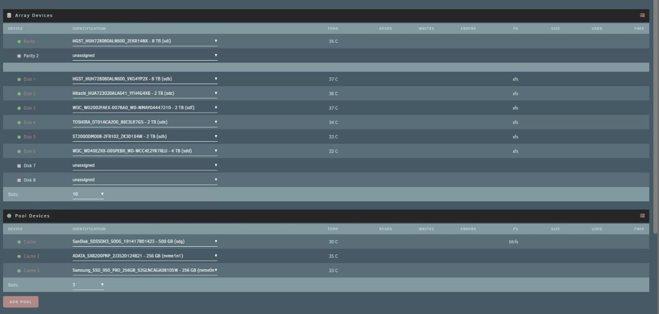

New config screen always pops up after a reboot.
Hi all I'm having a weird issue where whenever I restart of shutdown my server it comes up with the new config screen as shown below when it reboots, has anyone seen this or knows how I can stop it from happening??
All my data appears to be intact and when I click start the array, it appears to start just fine. It just seems the array ALWAYS boots up in a stopped state.
Solved by itimpi
That looks like the standard screen if the array is not started.   Have you enabled Autostart under Settings->Disk Settings?   If you have you should post your system's diagnostics zip file so we can see what is happening.
It was indeed set to Autostart : no. Im not sure why unless this is a side effect of a new config, but it seemed to do the trick.
