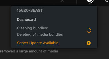

Today, I tried to delete the offending show - never really cared about it anyways.  Then I went to Plex Setup -> Troubleshooting -> Clean Bundles... Plex has been "Deleting 51 Media Bundles for over 2 hours now:

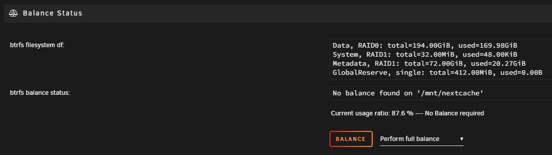

The underlying disk(s) is an SSD cache pool in Raid0 (sdb & sdc):

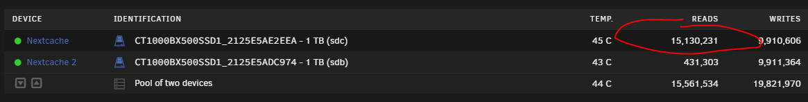

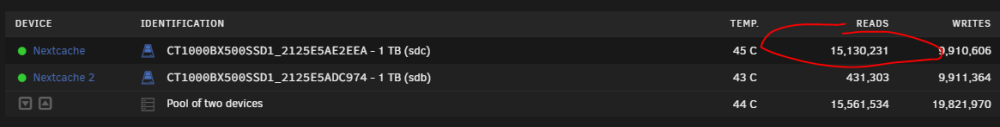

During this 2+ hour bundle delete operation, the read counter is wildly out of sync on the cache pool between these two devices:
Is my BTRFS messed up?  Could that be causing my issues?  Adding a current diagnostic if it helps.  thx again for looking @JorgeB.  Would be happy to try any ideas you have to unstick this.
15620-beast-diagnostics-20231026-1022.zip
Pool looks fine, it's using raid0 but I assume that was a choice.

Any ideas on why the write counts are so lopsided?
Any ideas on why tar-ing (or even rsync-ing) plex bundles on the cache pool never finish?
Again, thx for the attention. Not your job to fix my stuff.  Nice to have someone to bounce ideas off of.
Metadata is raid1, so reads can just use one of the devices.
