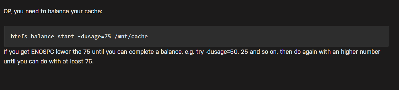

1 hour ago, JorgeB said:
Pool is missing a device and the other is fully allocated, so it's going read-only, disable docker/VM services and reboot, if the pool doesn't go immediately read-only you need to free up some space and rebalance, see here:
https://forums.unraid.net/topic/62230-out-of-space-errors-on-cache-drive/?do=findComment&comment=610551

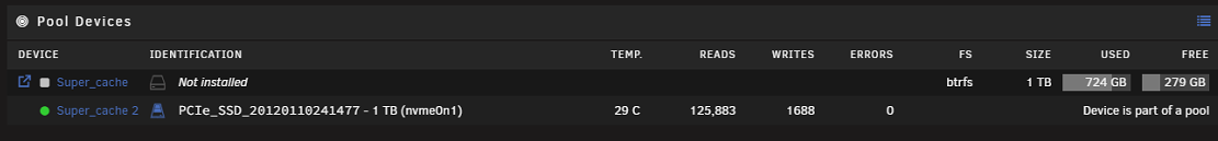

I don't think it actually is full though. The "Super_Cache" pool has 2 1TB drives (super_cache and super_cache 2). 1 disappeared (aka missing) but everything was working fine after I acknowledged that it was missing, since the drives were mirrored (1TB actual space). I was having no issues with docker until this morning. I monitor that capacity closely and they were ~70% full before all this happened. GUI currently shows the remaining drive (super_cache 2) w/ 279GB free space.
Strangely, du -sh super_cache/ shows total size of 476GB. But regardless, it shouldn't be full.
It's not full,
is fully allocated
But the result is the same, it won't be able to write any data until there's some free space to allocate new metadata chunks.

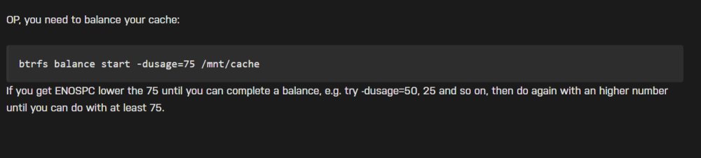

That's strange, works for me:
You need to free up some space first or the balance will likely fail.

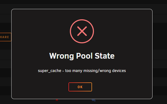

Now getting this error when trying to start the array. Latest diags attached.

@JorgeB OK, I reseated the nvme drives and the missing one is back. I reassigned it to its original spot but I am unable to start the array due to the above error (Wrong Pool State). Here is what the GUI looks like:
Not sure how to overcome that error. Any help appreciated. Sorry to bug you.
WOO! Got it working by unassigning both cache drives, starting array, stopping array, reassigning cache drives, and starting array.
