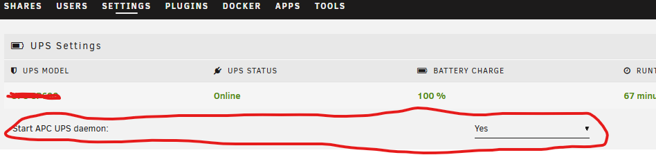

As I interpret the short section of the syslog, those lines are from apcupsd plugin that is the default in Unraid.  If you are truly using NUT, you need to go to
         SETTINGS    >>>   UPS Settings     and make sure that this setting is disabled:
(I use apcupsd to control my UPS for my Unraid servers, so I have it enabled!)
Edited by Frank1940
i've tried all the combination, NUT enabled APC daemon disabled, both disabled only APC daemon enabled and nothing works. Once I've maaged to set ups status online in UPS Settings but power had 0 state, next I managed to see power in NUT for a while but its all random.

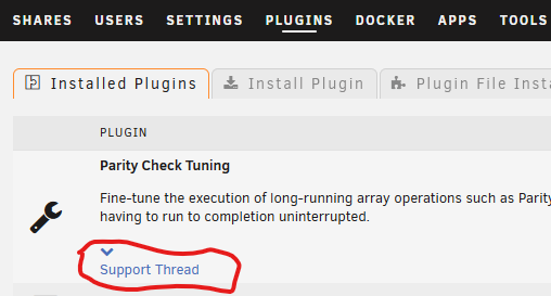

Try asking in the Support Thread for NUT to see if there is a solution.  (For any plugin, you should find this link as shown here:)
Also consider contacting the vendor/manufacturer to see if their product uses a communication protocol that is supported by either of these two (apcsupd and NUT) software packages.  (They could be using a proprietary  protocol...)
