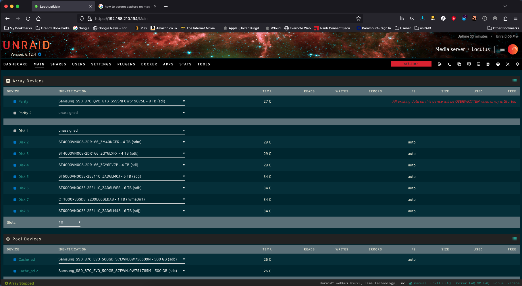

To save my data I shutdown the server after restarting disk 1 is now showing as missing with a red cross.
That's unrelated to the previous issue, check power/connections.
45 minutes ago, Mirrormir said:
In an attempt to bring disk1 back on-line I made a new config but now it's not showing up, so seems to dead.
That was a bad idea, now you cannot emulated the missing disk.
Okay my fault so what the best way forward from here?
Does the disk come back online if you swap cables with known good ones? Did you star the array after the new config? If not it's still possible to re-enable parity, you need a working disk to replace the missing one, same size or larger.
All the disk cable used in the Array are connected with SFF 8087 to SATA from a SAS HBA. Disk1 however has turned up under Unassigned Devices for some reason.
And no I didn't start the Array.
You can then re-assign disk1 and check parity is already valid before starting the array, start in maintenance mode to avoid the crash due to disk1 filesystem, then repeat the procedure above mo mount disk1 read only and start the array normally, post new diags after that.

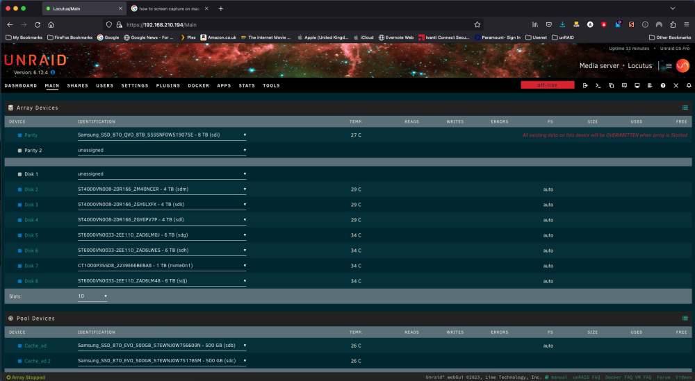

Thanks Jorge,
Just to make sure I get this right, I will need to remove disk1 from the Unassigned Devices and then assign it back in the Array as disk 1.
Is that correct?...
Yes, if you didn't start the array after the new config all devices will have a blue icon and you can still add disk1, don't forget to check "parity is already valid " and " maintenance mode " before array start, any doubts ask.
Thanks Jorge,
Sound good parity is showing valid.
