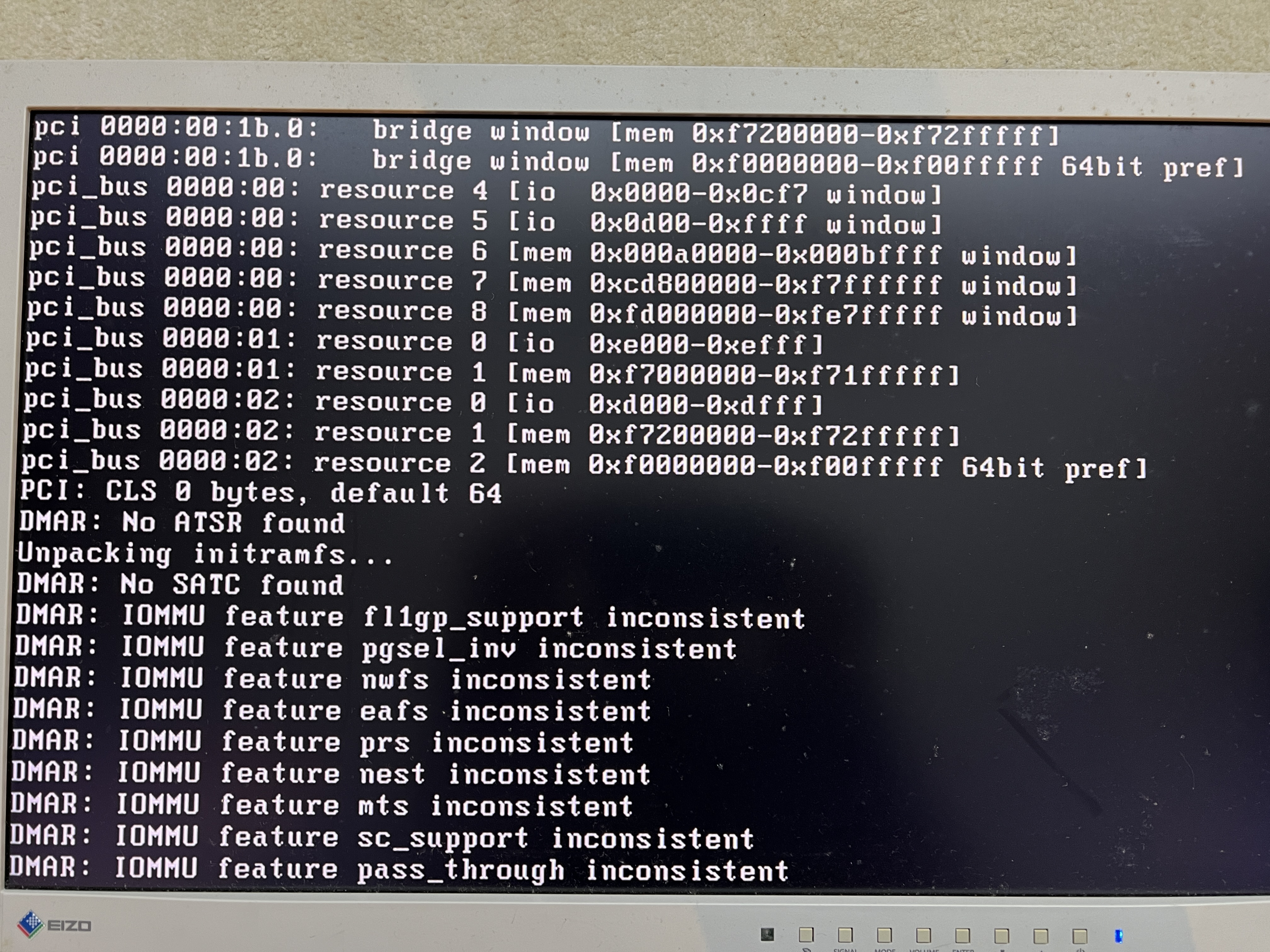

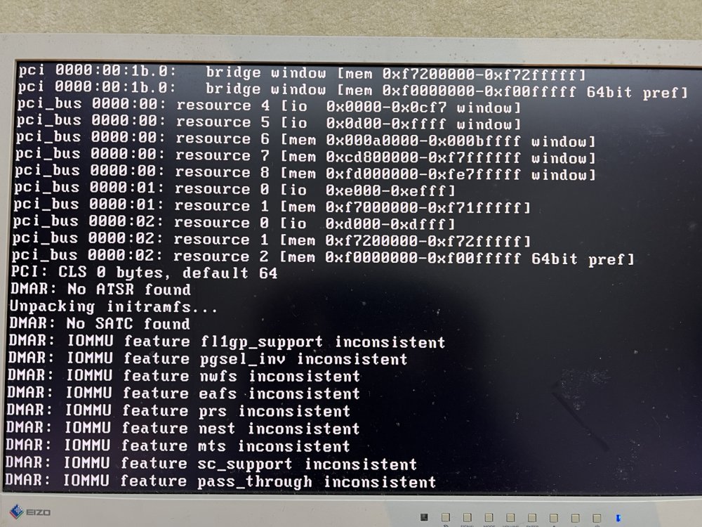

today I experianced a fundamental server crash. After reboot I don't reach the point where I can connect to the server via network. Attached you find a screenshot from the local attached screen. Can you help? What is potentially damaged? Thanks a lot!!!

That could be a hardware issue, but try recreating the flash drive, backup current /config folder, recreate, test if it boots with the stock install, if yes restore the /config folder from the backup.

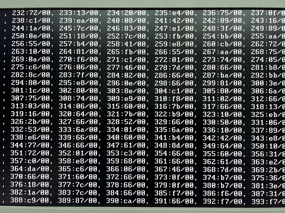

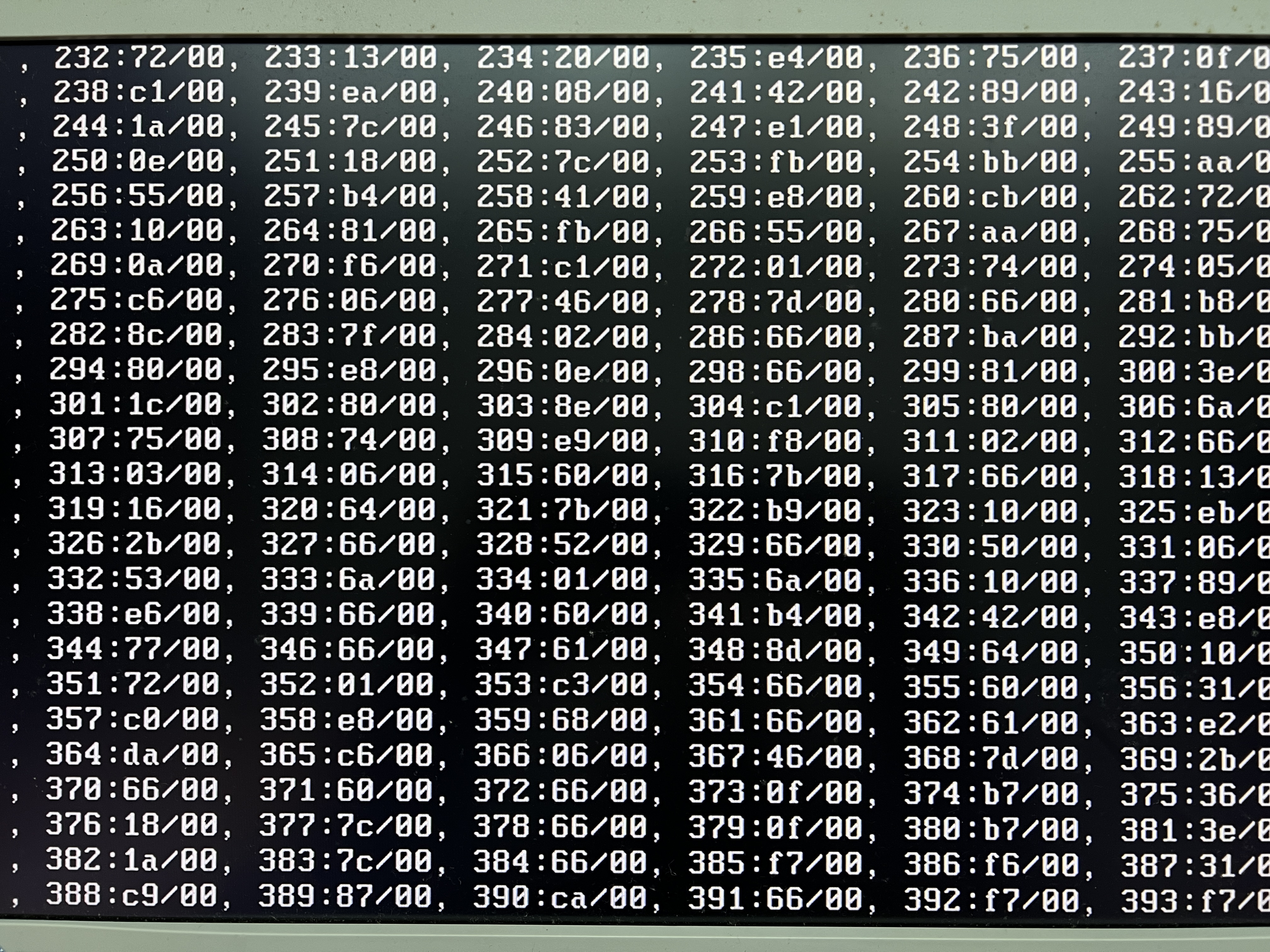

I extracted the /config folder from the current USB-Flash drive, created a new flash drive (64GB) and copied the /config to new usb stick. I ended up with a strange kind of error (see the attached picture). I booted with a different UnRaid stick and the server booted correctly. So, it seems that I haven't an hardware issue but an issue with the usb stick and the config data itself. Any idea what to do next? Thanks
Never seen anything like that display so no idea where it could be originating from.
During troubleshooting the unraid-server wasn't connected to the network. After connecting the server to the network, I was totally stunned 8-))))))))) that the GUI is accessible and also usable. Everything looks fine and after replacing the license key, everything is up and running again. I can open a working terminal via SSH. On the local screen I still see this weird screen as shown above and no local terminal. I'm not really sure that everything is fine, but for now, I'm pretty happy!!!
