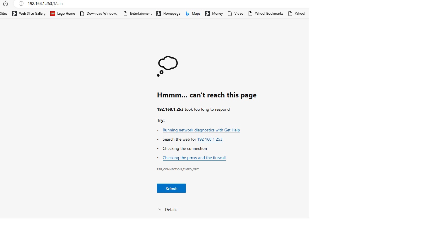

so i am having a problem accessing my server using the url but if i go to This PC/ Network it is there and i can see server and folders on server but not the main console , i have tryed to turn of firewall no difference any help please

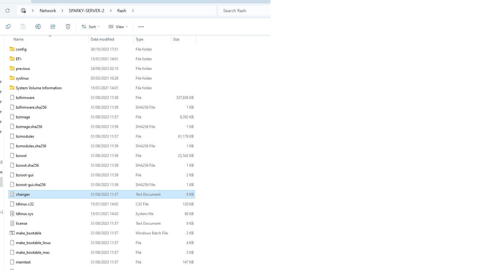

hi thank you all for help i do not have anything that says logs look everywhere
If you have a monitor and keyboard connected to the server, go there and type diagnostics, they will be saved to the flash drive, /logs folder, upload that zip here.
that is all i can access when i put the flash drive into computer

One moment everything was working and now I get the message unable to connect.
I am at a loss. I have reset the router to factory settings I have looked at the firewall and proxy settings on my linux machine that I am trying to connect to the unraid machine with.
Is it possible that a security setting has been enabled or disabled that I am not aware of?
