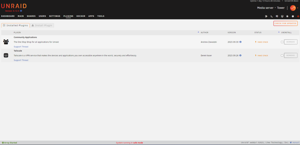

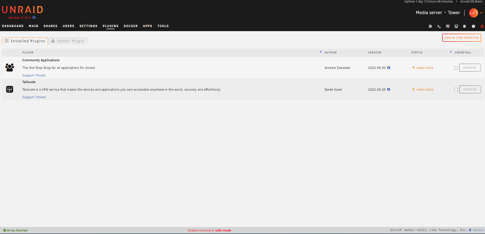

Screenshot below just to show I'm not making it up - in safe mode was able to re-install community applications and Tailscale running ok.

I think you must have reinstalled Tailscale after booting in Safe Mode?
Update your Tailscale plugin, there was a weird interaction with the WebGUI in that version which resulted in the WebGUI process hanging.
