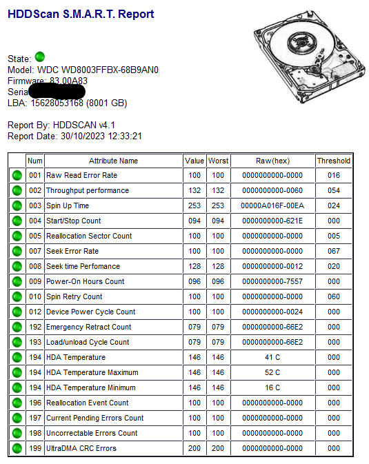

The disk3 and 4 failed several days ago too, but the SMART values are look good in my optinion. I did some tesing on my workbench PC and the disk3 did not show any signs of failures/errors.
