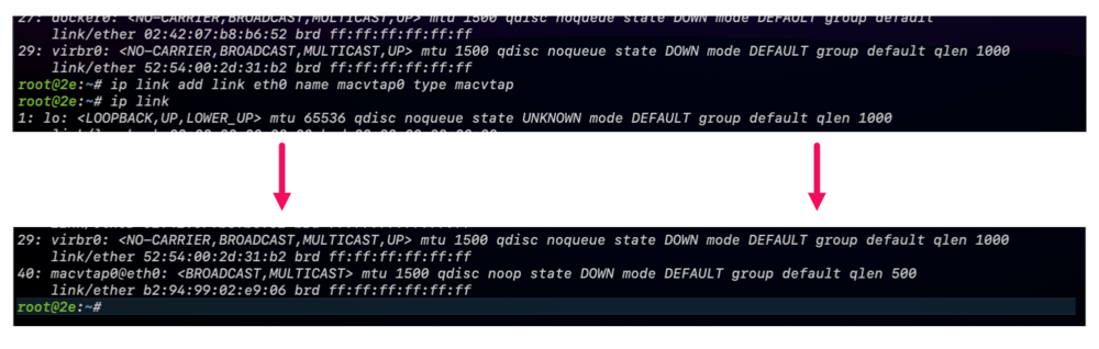

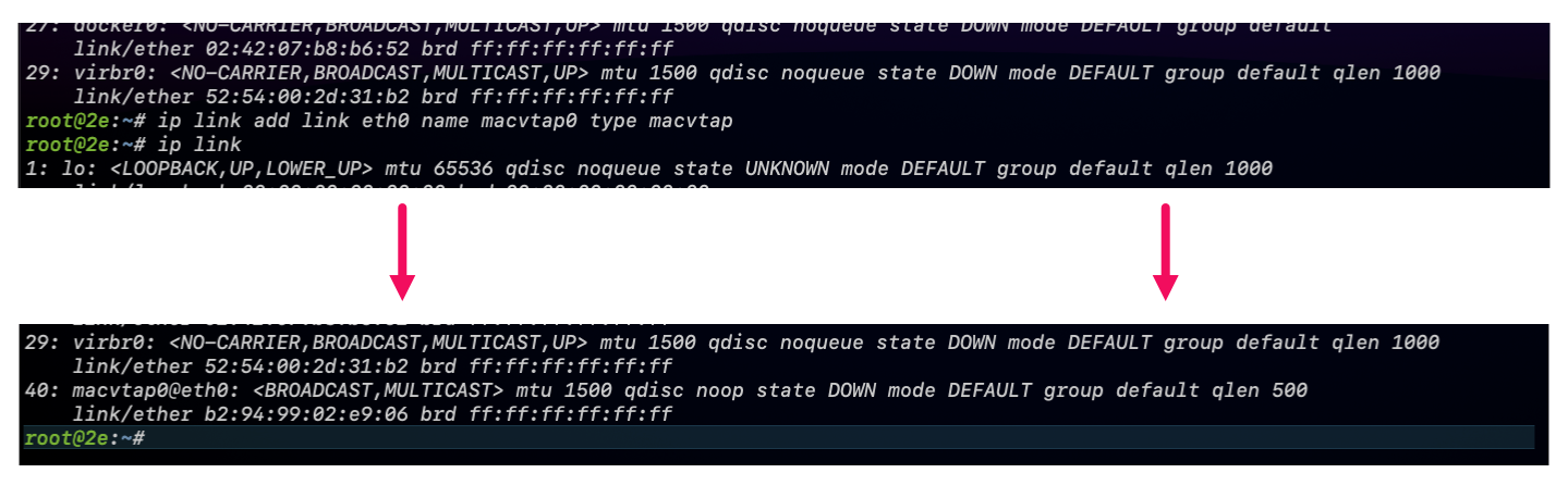

I tried it:

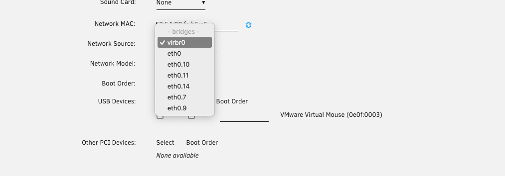

and...:
(not there.)
But as I mentioned, I can't actually run VMs, I can only pretend to make them, and a lot of things in Unraid don't present themselves unless you select something else and things of that nature. Also, ip commands are ephemeral; this wouldn't survive a reboot.
