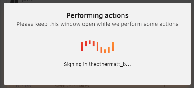

I tried to connect my server to Unraid Connect and it just sits at the "signing in" screen indefinitely.
I've tried it after rebooting and with multiple browsers, still no dice.
Anyone have any ideas?

I am hitting the same problem. I then tried using Chrome incognito tabs to do the whole process like another user recommended, but that didn't work either. How long is this "performing actions" supposed to take, cuz I leave it for 10 mins and it's still not done. I think it's frozen. I can open up the Connect Dashboard on another tab and I know the the server is connected to the internet (it can check for updates).
I wish it would give a useful error message instead of spinning forever like this.

Also has the same problem. Can't connect - hangs with the same performing action ;(
ok solved the issue. It was becouse graphql cors was not allowed from domain. I added my serwer to dns as servername.lan and it doesn't work. Started via ip solve the issue.
