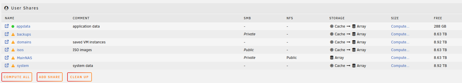

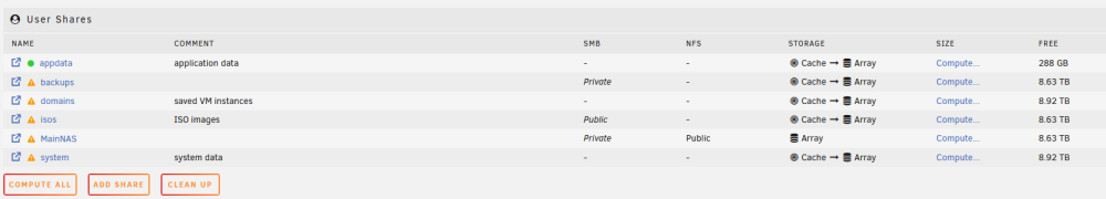

After rebooting, I noticed that all of the shares in my shares tab were gone. I checked with "ls" to see that the data was actually still physically there on the disks (it is). I also tried updating to the latest version of unraid, which did make the shares show back up again, but when trying to access them over SMB it's totally empty. Additionally, all of my VMs are gone, and the docker tab says "Docker service failed to start".

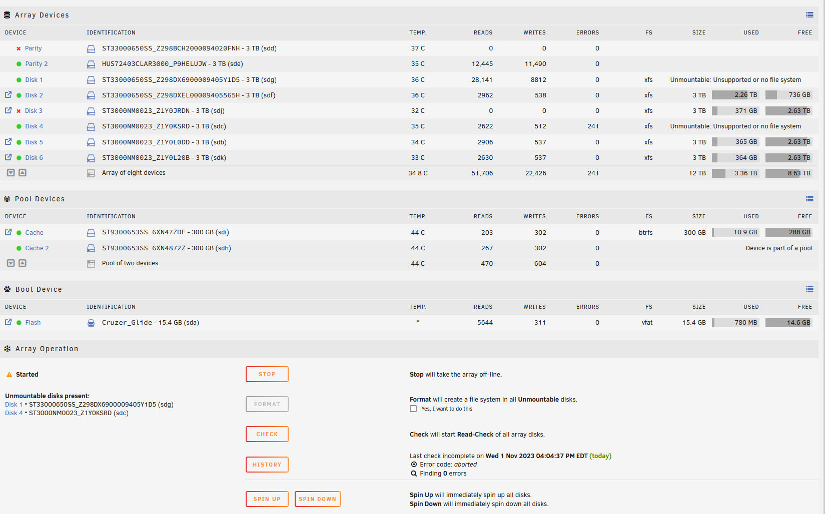

Strangely, after updating and rebooting, now two of the disks show not only as disabled, but also show as unmountable.

In addition to other issues there were write errors with disk4, replace cables and post new diags after array start.
It's in a R720xd so it's just a backplane, no cables to replace. I also don't have physical access to the server at the moment, as it's a few thousand miles away and I'm remoting in. I've tried running xfs_repair and for all of the disks it's failed with "xfs_repair: libxfs_device_zero write failed: Input/output error".

No point in attempting xfs_repair with disk errors, it can make things worse.
