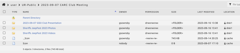

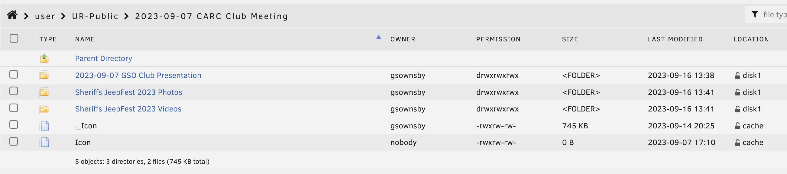

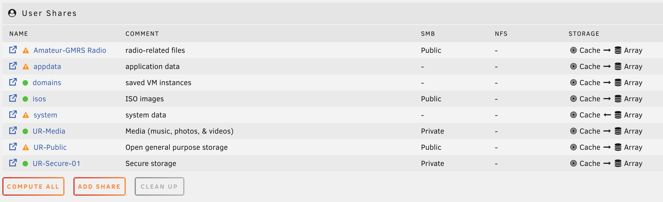

My Unraid Server has been going for well over a month.  I'm puzzled as to why the caution symbol appears (Some or All Files Unprotected) for some folders/files.  See screenshots attached.  Those files appear to be system-owned files (._Icon / Icon), so why does this happen and is it something I should be concerned about?  If not, how do I make it stop flagging them?  Thank you.

They show as unprotected if there are some file/folders for the share are on a cache pool and the pool is set up to not be redundant.

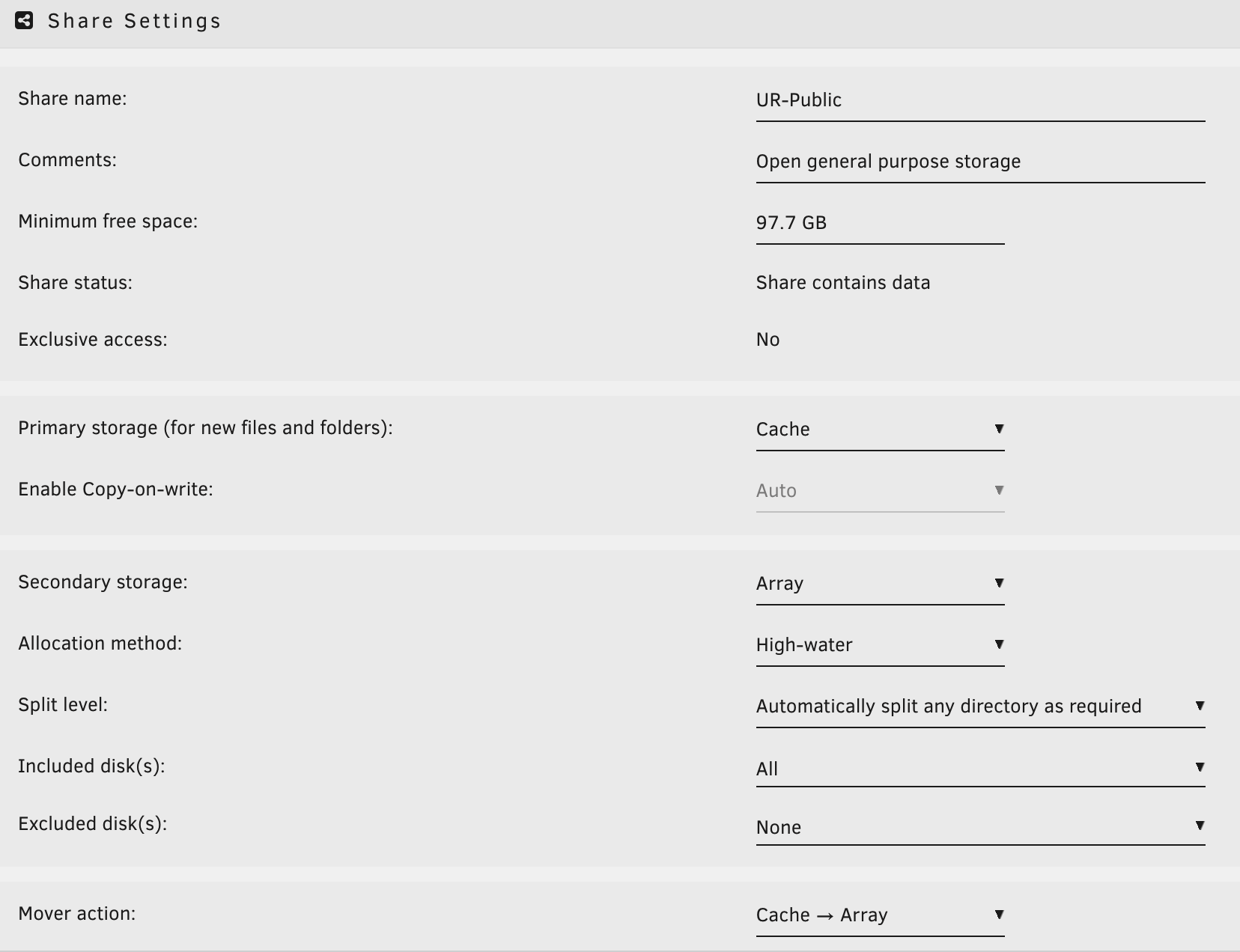

I understand that well enough; however, when I look at the settings for the upper tier folder, does this not show that it is set to be cache and array?  See screenshot below.  It appears to be only the "Icon" files that are causing this problem; however, I cannot delete them or move them out of this folder.  I'm not even sure what they are.
One possible reason is that you can't move (or delete) files that are open.
Files that begin with a 'dot' are normally hidden files.   Files are generally hidden so that they can't be 'accidentally' modified by the casual user as they are generated and used by some program to store settings or other runtime information.  The file, Icon, has zero information stored in it at this time but you probably knew this.  Does this condition change over time?
EDIT:  Just tried something.  Open the share with SMB on your PC and see if you can copy the ._Icon file to your PC.   (I just copied a a file file from a share to which I  had read-only access to my Desktop.) At that point you can open the file (I would start with Notepad and move on to photo-viewers) and see if you can figure what it contains.
