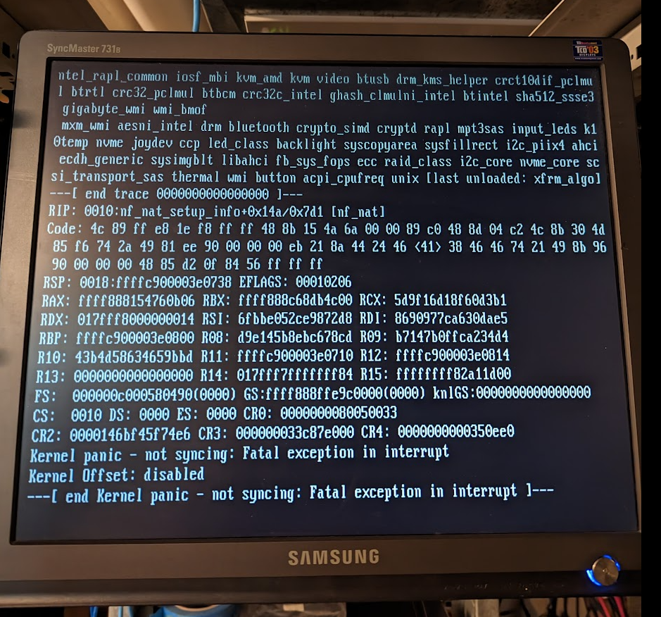

I recently rebuilt my array after some drives failed, or went missing.  Things were fine for a day or two then one morning this week unraid wasn't responding checking on it I saw what looks to me a link a kernel panic.
<screen shot attached>
I was forced to power cycle unraid, and twice now during a parity sync the same thing has happen by the next morning.
Anyone have any ideas what may be the problem?

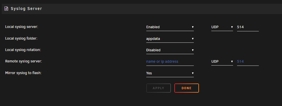

Ahh I see, here's a copy of the logs directory from the flash drive.  That documentation seems to indicate it should have been mirroring the logs to there.
But I also noticed this folder selection in the settings, but I guess that must be something else I don't see anything pertaining to system logs in the selected appdata folder.
logs.zip
You nee to input the server IP in the remote syslog server field.

Nov  3 22:34:00 phoenix kernel: macvlan_broadcast+0x10a/0x150 [macvlan]
Nov  3 22:34:00 phoenix kernel: ? _raw_spin_unlock+0x14/0x29
Nov  3 22:34:00 phoenix kernel: macvlan_process_broadcast+0xbc/0x12f [macvlan]
Macvlan call traces will usually end up crashing the server, switching to ipvlan should fix it (Settings -> Docker Settings -> Docker custom network type -> ipvlan (advanced view must be enabled, top right)).
I went back and filled in the server IP of my unraid server.
I also adjusted the docker networking setting you suggested and changed it from macvlan to ipvlan
I don't see anything different in the logs folder on the flash drive.   attached as log2.zip
logs2.zip
But I did find a syslog file in the appdata folder, maybe that is being mirrored to the flash drive and I just didnt see it?
syslog-192.168.0.216.log
The 'syslog' file in the 'logs' folder is the one that is being mirrored to the flash.

Yes it is.  Took longer this time was up for ~2 days.
Woke up to it crashed this morning, before I grabbed those last logs above.  Same crash screen on the monitor as above (kernel panic).
Last macvlan crash I see logged is from Nov 6th, and no toher call traces after that, did you reboot after changing to ipvlan?

It has crashed once since I changed to ipvlan.
Found it that way the morning of Nov 8th if I recall correctly and had to do a hard reboot (reset switch).  As of 10am Nov 9th its still up and running.
If it crashes and I have to hard reset again, I'll grab new logs and diag files.  Hopefully it was just that macvlan setting or something else points to a fix.
