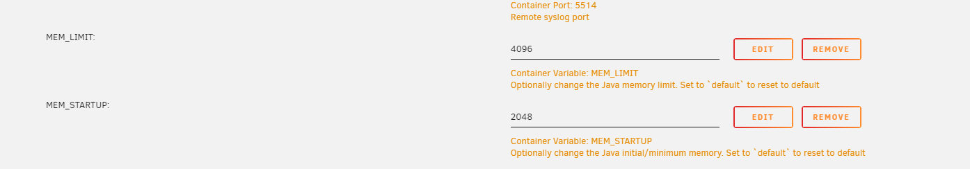

Hi. The app has been working well for me but all of sudden it won't start and seeing the below in the logs. Anyone know what might be going on?

31 minutes ago, andyd said:
That is actually the output. The docker will not start up
You ran out of ram / memory.
What is you docker setting for java ram?
Also what is you container tag?
I would have you drop the ram requirement to the bare min.
https://help.ui.com/hc/en-us/articles/360012282453-Self-Hosting-a-UniFi-Network-Server
Per unifi 2 GB is min spec: RAM: 2GB.
under extra parameter st to 2G no 8G. 4G is preferred.
In template, set Mem_Limit to 2048.
This will force set 2GB to the docker for this application.

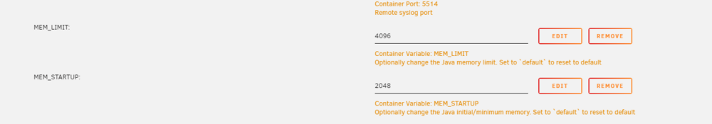

It's ...
11notes/unifi:8.1.113-unraid
And the values are the default ones - 2048 for startup and 4096 for limit
Are you saying that MEM_LIMIT and MEM_STARTUP should both be 2048?
And for Extra Parameters, set this to 8GB? What config type is that?
Edited by andyd
1 hour ago, andyd said:
It's ...
It seems like unraid is killing the docker. Check you didnt run out of ram globally. Test by stopping all VM’s and All dockers and starting only this one. If it starts then you have some issue above the container you must resolve.
If you have the extra parameter, which is in the current template for downloading from the community app store. The extra parameter is set to 8 GB which is a pinning parameter you would want to lower that.
Yes I would recommend lowing the other 2 to 2 GB. Then try again.

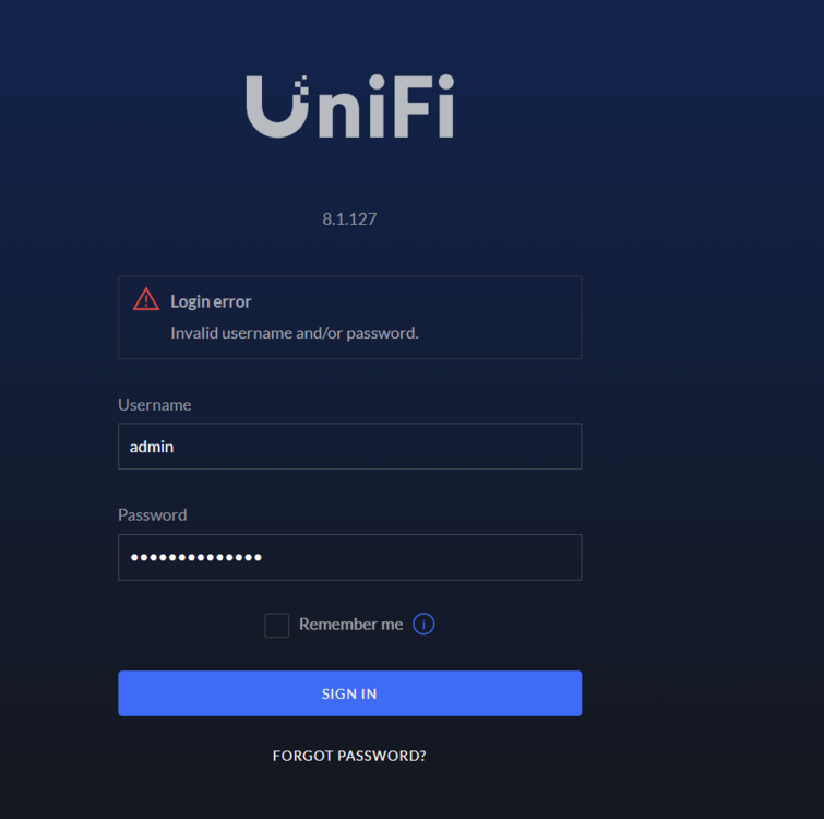

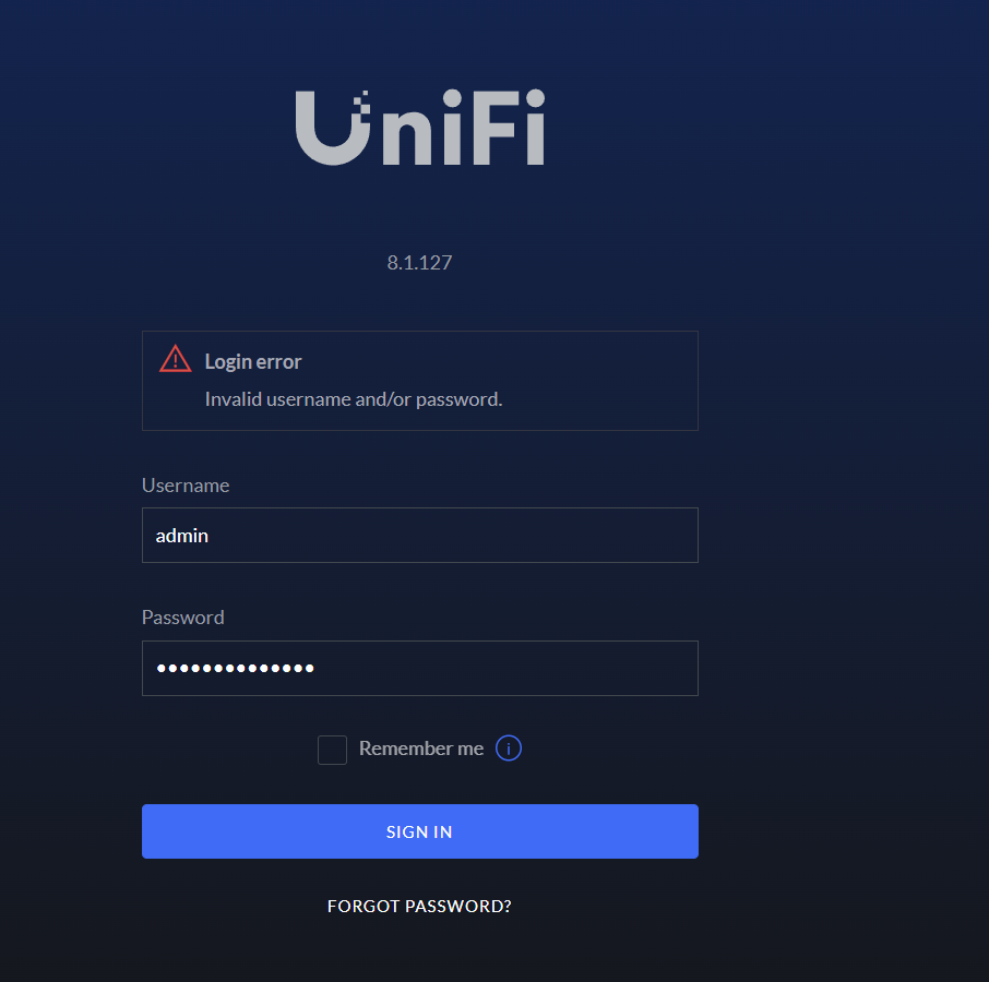

When restoring from backup on unifi:8.1.127-unraid no users seem to migrate which does not allow me to login.
mongo --port 27117 ace --eval "db.admin.find().forEach(printjson);" shows no admin users. I remember my password fine for the local login, but nothing seems to work. Ideas?

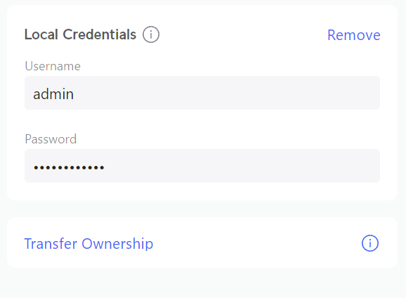

Did you not have the ‘Sync Local Admins with SSO’ option ticked?
Where is that option? and should it be ticked or unticked? I had a local account setup under the owner account. I even created a separate "unraid" admin account for testing and neither are allowing me to login.

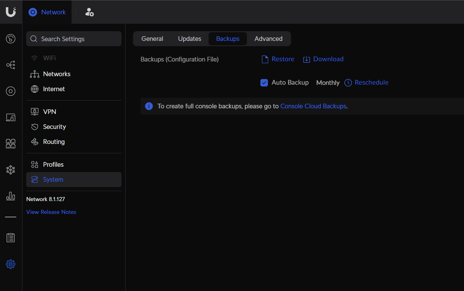

How did you create the backup?
Download from within the Unifi Network App
It seems this is a common issue with the Unifi controller. Here is an example here: https://community.ui.com/questions/Logins-not-working-after-restoring-backup-to-new-machine/023647bc-2953-421f-ac05-4a19072d702c
under legacy interface can you go to settings and then ‘admins’ and review the list of admins there and possible create a new one. Under the modern interface the sso option that links your unifi account on their website to your local deployment is under system - advanced and allows you to remote manage it at https://unifi.ui.com
you can try enabling this also and seeing what happens after a restore.
let me know after doing some troubleshooting like this.
