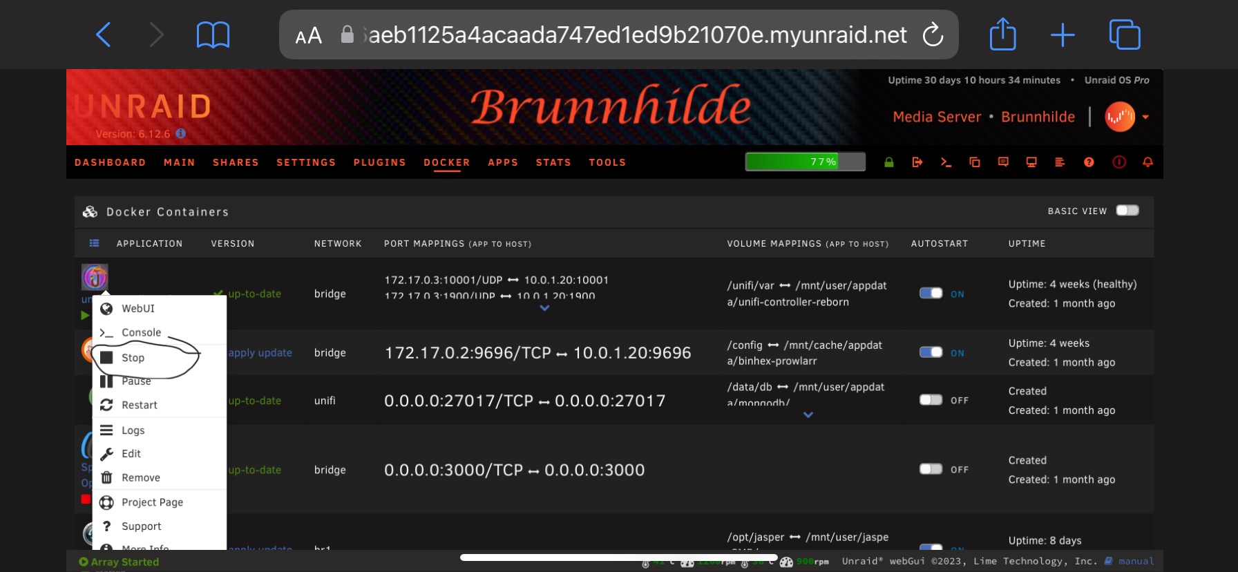

45 minutes ago, DWomack said:
what do I enter at the command line to shut down the running controller
In unRAID you would just click the docker icon and select “stop”.IMG_2624.thumb.jpeg.fdb735107076bd99611c851f26acd9a0.jpeg
On the command line enter
docker stop <name of docker>
