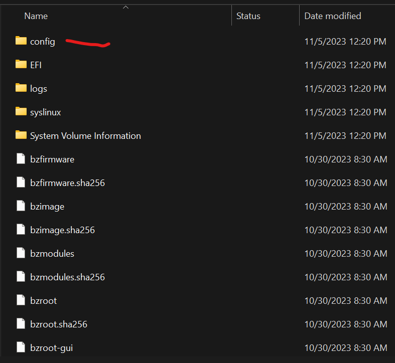

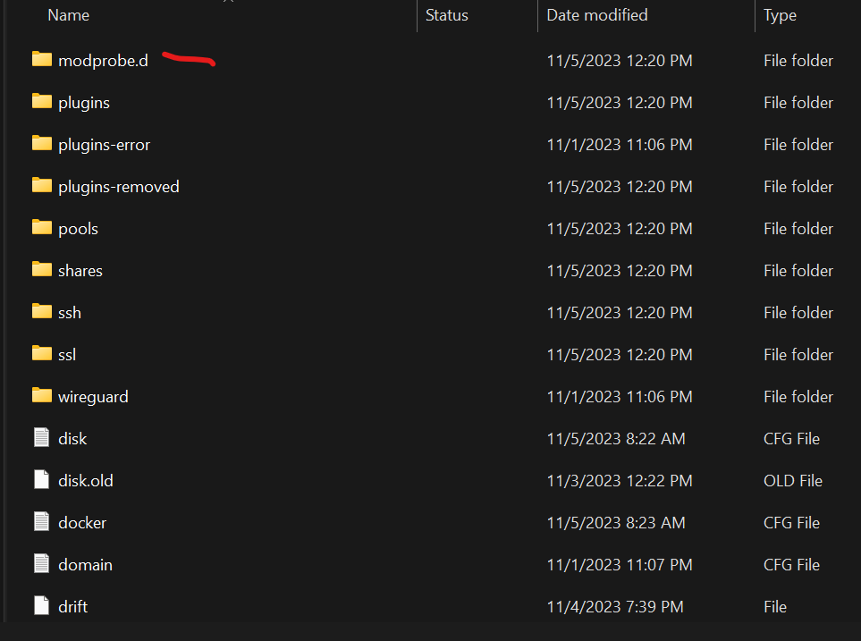

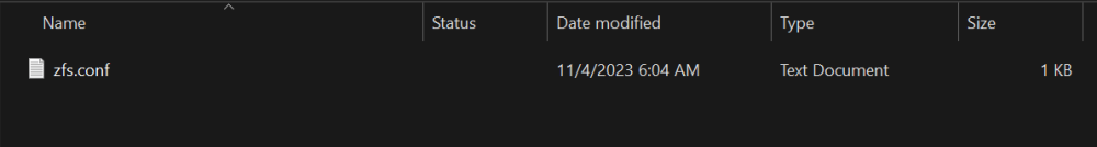

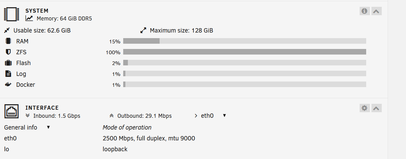

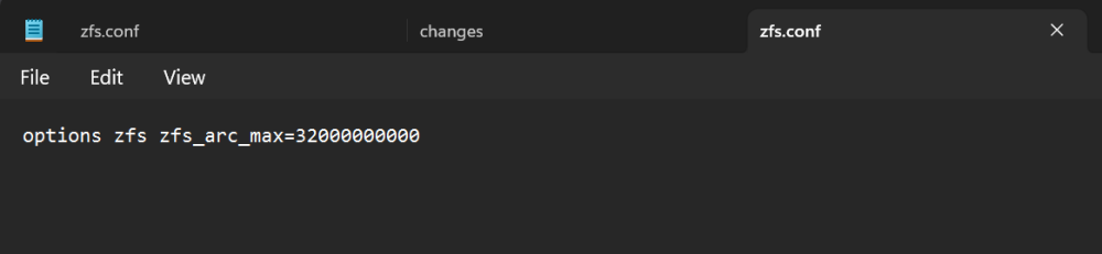

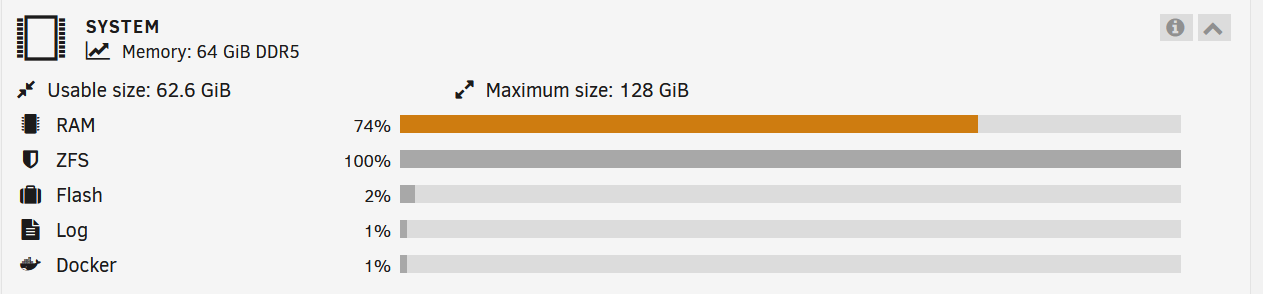

November 5, 20232 yr Hi experienced Unraid users! I have little experience with this, so I'm hoping someone from the community can help me. I've just created a new server and have been brave enough to try ZFS! LOL. I installed 64 gigs DDR5 RAM to support ZFS, but it seems to be barely using my RAM. Per the Unraid notes, ZFS is only allocated 1/8 or your RAM. My server really is only a NAS, so I want to give ZFS as much RAM as I can. I thought I'd start by trying 1/2 of available RAM. Here's what I did. I went about trying to do this by: - Shutting down server and putting USB Unraid boot drive into my PC. - I then went to the config folder - went to modprode.d folder - created a notepad doc with this text: options zfs zfs_arc_max=32000000000 - saved it as zfs.conf in the folder - ejected USB from my PC and plugged back into my server and booted up. Now have the below result. I'm not sure it helped. I'm trying to allocate 1/2 my RAM. Am I doing something wrong? Thanks so much in advance!!!
November 5, 20232 yr Author Solution Sorry!!! I figured out what I did wrong. For others who may be inexperienced like me, chatgpt said don't use notepad like I did. There was an extra empty space at the end of the string. I downloaded notepad ++ and up'd my allocation to 48, and now check it out! But now it's orange. LOL, did I go for too much?

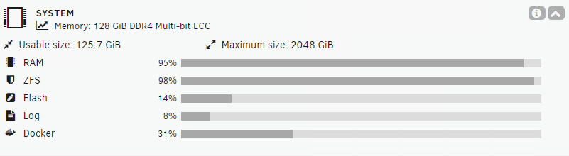

November 6, 20232 yr Community Expert 14 hours ago, Kirk4444 said: But now it's orange. That's controlled by the default warning/critical disk utilization thresholds (Settings - Disk Settings) 14 hours ago, Kirk4444 said: LOL, did I go for too much? Depends on your needs, if you use VMs you can have issues starting one if it needs more RAM then currently free, since sometimes the ARC cannot release the RAM fast enough making the VM crash on first start, if you doesn't use VMs you should be able to use even more, e.g this is one of my servers, doesn't run any VMs so I use almost all free RAM for ARC:
