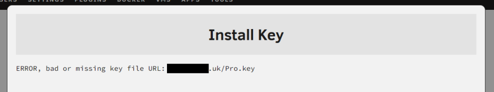

I dont think I do... sadly my home UnRAID machine is down as the USB key died and I cant get that working again and if I have a backup it would be on the home machine :( I uploaded the Pro.key file on one of my VPS which hosts a webserver... in the Tools > Registration GUI there is an option to Install Key and it asks for the key file URL... but when I put the URL of the webserver where the keyfile is hosted it still fails :(

OK, I managed to SSH to the /boot/config folder and imported the Pro.key.... then rebooted and "Replaced" the key... so, in case anyone else has this issue you can use something like WinSCP to access it ;-)
