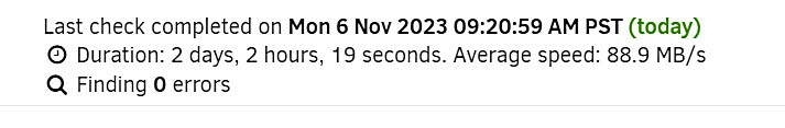

I've been using Unraid for about a year and a half now. My use is nothing exotic, just as a backup destination for several computers on my local network.
My array is currently 2 16 TB parity drives and 3 data drives (14, 14, 16). SATA interface.
Parity check takes about 50 hours for that array. The speed is about 85 Mbytes/sec. Is that about what you would expect?
Also, the array is about 75% full. Any guidance on how full it can get before it would be a good idea to add an additional data drive?
Edited by tomc
Solved by JorgeB
That's on the slow side, start by posting the diagnostics so we can see the hardware.
You are using a controller with a SATA port multiplier, and 4 of the disks are sharing the same SATA port, so bandwidth is affected a lot, see here:
Thanks.
I will look into better interface options.
What I have now works, but from that thread on recommended controllers it looks like it could be a lot faster.
Tom
