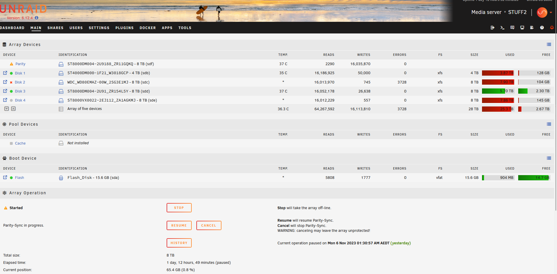

Originally it was only one, so I relocated that drive to a known good bay and it was happy. Now, in what was most likely a stupid thing to do, I let Unraid start a parity sync after starting as I thought it would be good way to confirm I wont be getting any more CRC errors...
So it did not go well, another drive during this sync threw so many errors that unraid has now disabled it, and the parity has paused. In looking, this drive may actually be faulty beyond my original CRC issue.
So, now I feel like I am in a precarious position, as my parity is now in an unknown state and 30% of my files are not visible (e.g. unraid is not emulating the disabled drive). That is my biggest worry - that the missing drive is not being emulated...
What should my next step be? I am happy to pull the potentially faulty drive and manually recover the files from it later, but am unsure of how to go about this while keeping the current setup with what left set up remaining running.

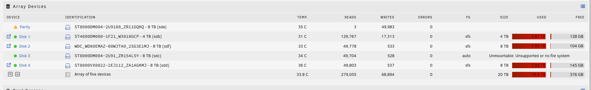

I did that, and it does not look promising...
Unraid now thinks the disk has no file system :(
I paused the parity sync

Problem now is with a different disk, cancel the parity sync, stop the array, click on disk3, change the filesystem from auto to xfs, then check filesystem on that disk, run it without -n
