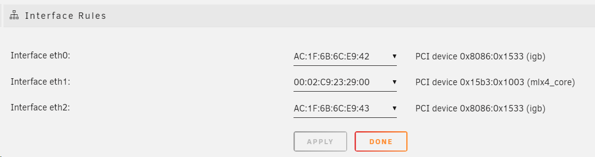

Eth0 is the default connection of the system and it will not let me change/remove that. Eth0 is a 1G port that is always set as the active member. Meaning that no matter what changes it will only ever communicate at 1G. Guess I have to goto the console to try and figure out how to get Eth0 off the network members.
You can change which NIC is eth0, Settings - Network Settings - Interface rules (need to reboot to apply)
eth0 is a specific interface. It doesn't let you remove it or change which interface it is. At least not from the GUI. That is a Linux setting and eth0 corresponds to which physical interface what that MAC address.
24 minutes ago, JorgeB said:
changed that and no difference. still only going at 1G
Assuming you rebooted first and bonding is still disabled then you have another issue.
