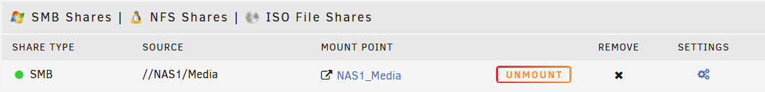

You can use the UD plugin to mount the Synology SMB share.
Unassigned Devices? Hold my coffee, IM GOING IN!
Sweet. I got UD to mount my Synology NAS media folder - Now I just need to figure out how to copy the data...

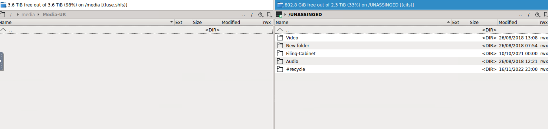

Hello, when I first setup my unraid server I copied thru a windows machine but then I saw spaceinvader one's video about copying data using Krusader...

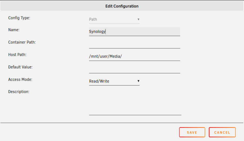

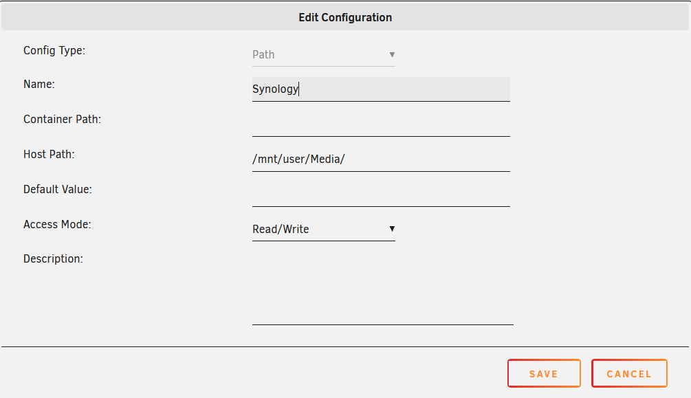

Filebrowser does not seem to see my mounted Synology NAS...
I think I need to squeeze this synology info into this filebrowser config....
If I could mark all responses as solved I would! Thank you so much! Got it all sorted! image.thumb.png.d9c558861e109abcbf66be80f0679271.png
