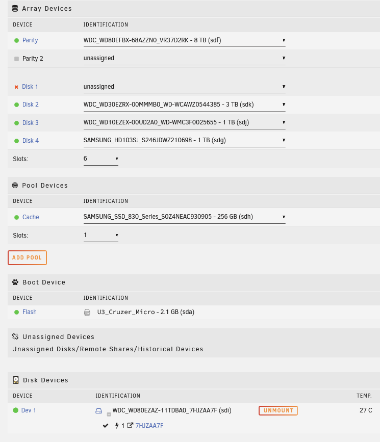

I'll state first I am a novice user. I was busy organizing family photos on a share and all of a sudden I was unable to create folders. I got a notification in the dashboard showing that a drive became disabled. I have one parity drive. In a slight panic, I looked up instructions on how to troubleshoot this problem. I downloaded diagnostics first. Then I followed instructions to stop the array and unassign the disk (I hope doing this didn't screw me over). Now I'm stuck here because I am unable to mount the array due to an error:image.png.ff6103e25b97cdb9c21fa714b55f5226.png
My setup sits looking like this:
I feel like I shouldn't have unassigned the device because I think the disk was being emulated, and I think I could've copied data at that point to an external source for good measure. But I had already unassigned the disk and can't reassign it. At this point, I am not sure what I should be doing and I'm afraid I am making things worse. I'd love to recover the data if possible. I am hoping that is what the parity will help me do.

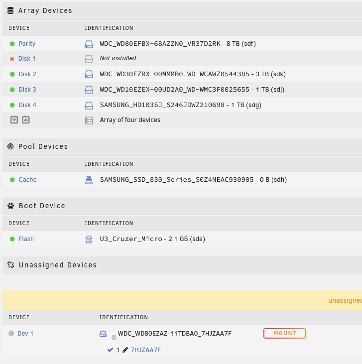

I also noticed my cache disk is now missing after a reboot. Is this an indication my psu is causing these failures? Seems like a weird coincidence. I'll shutdown the tower and call it a night as I've been pulling hairs for the past few hours skimming the forum and it's 3am here!
Disk1 dropped offline, looks more like a power/connection problem, but since it dropped there's no SMART, check/replace cables (same for the missing cache) and post new diags after array start.
Finally managed to squeeze in some time to open up my tower and reseat cables. So far so good; the missing drives are visible once more and after mounting the disabled/unassigned drive, it looks like everything is still there. I ran a short SMART scan and no errors. I'm not confident what could have caused the errors to begin with as nothing has changed.

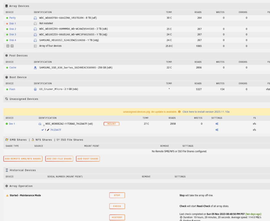

Hmm, thought I had started it when I downloaded the logs. Maybe I grabbed them too soon. I did start it in Maintenance mode, if that mattered. Anyhow, here it is again:
artemis-diagnostics-20231115-0950.zip
It does, start in normal mode, to see if the emulated disk is mounting.

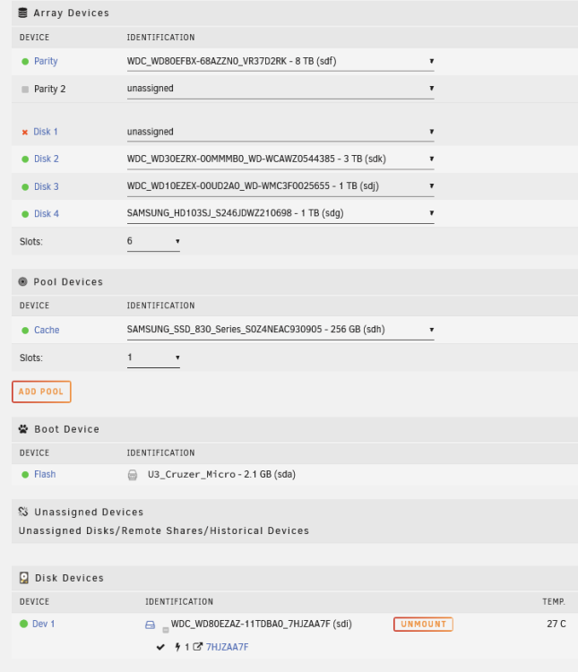

Understood. I started the array normally this time.image.thumb.png.cd96e958099d29572b7ac5252b58b289.png
