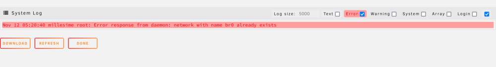

Hello I've been facing this issue since my last unraid update (==> 6.12.4), every 6 hours or so, my unraid server will become unreachable with no other option that hard reboot to get it back online.
I've looked into the syslog, I see errors related to the network bounding, but my networking understanding can't help me there.
Does anyone have faced the same issues and can someone have a look at the attached diag just in case I'm missing something ?
(My interface set up is : 2 mobo NIC, an Asus 10 Gbs NIC, all bounded with the 10gbs as main interface and one of the mobos as active backup).

Enable the syslog server and post that after a crash, the network config issue is probably unrelated, but should still be corrected.
