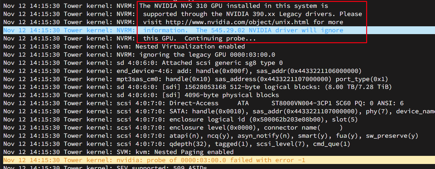

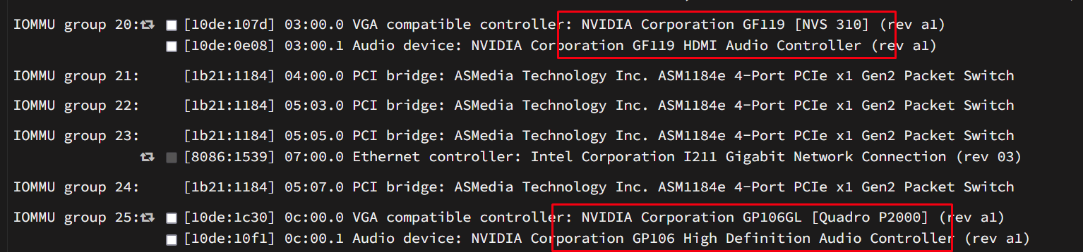

I have an odd situation I cant figure out.  My server has 2 GPUs installed which Unraid does recognize as being installed.  I have a NVIDIA NVS 310 and a NVIDIA Quadro P2000.  I want to use the NVS 310 for the rare instances when I need to pull up the Display and have been using the P2000 for transcoding.
But I cannot get any display output when hooked to a monitor.  I have tried multiple cables with a monitor I know works as I use it for other things.  I dont even get any output during the POST boot.  It doesnt matter which port I plug it into, I cant seem to get any display output.  Anyone have any ideas?

Solved by mattekure
hmm, maybe the NVS 310 is not supported at all.
