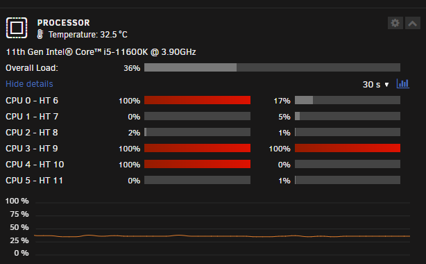

Data point: removed nearly all my plugins, all VMs off, only Plex and Homebridge running.
Caught server with random CPUs pinned; server idle (I had a sync running from another VM pulling files onto my backup NAS; terminated that and shutdown the VM; no change). Not sure if it's related, but it doesn't seem right. No crash yet. Nothing in "Processes" with any significant CPU usage; only 2 above 0.1%, (6% & 2%) - not sure how else to determine what is using it.
vesper-diagnostics-20240131-2055.zip

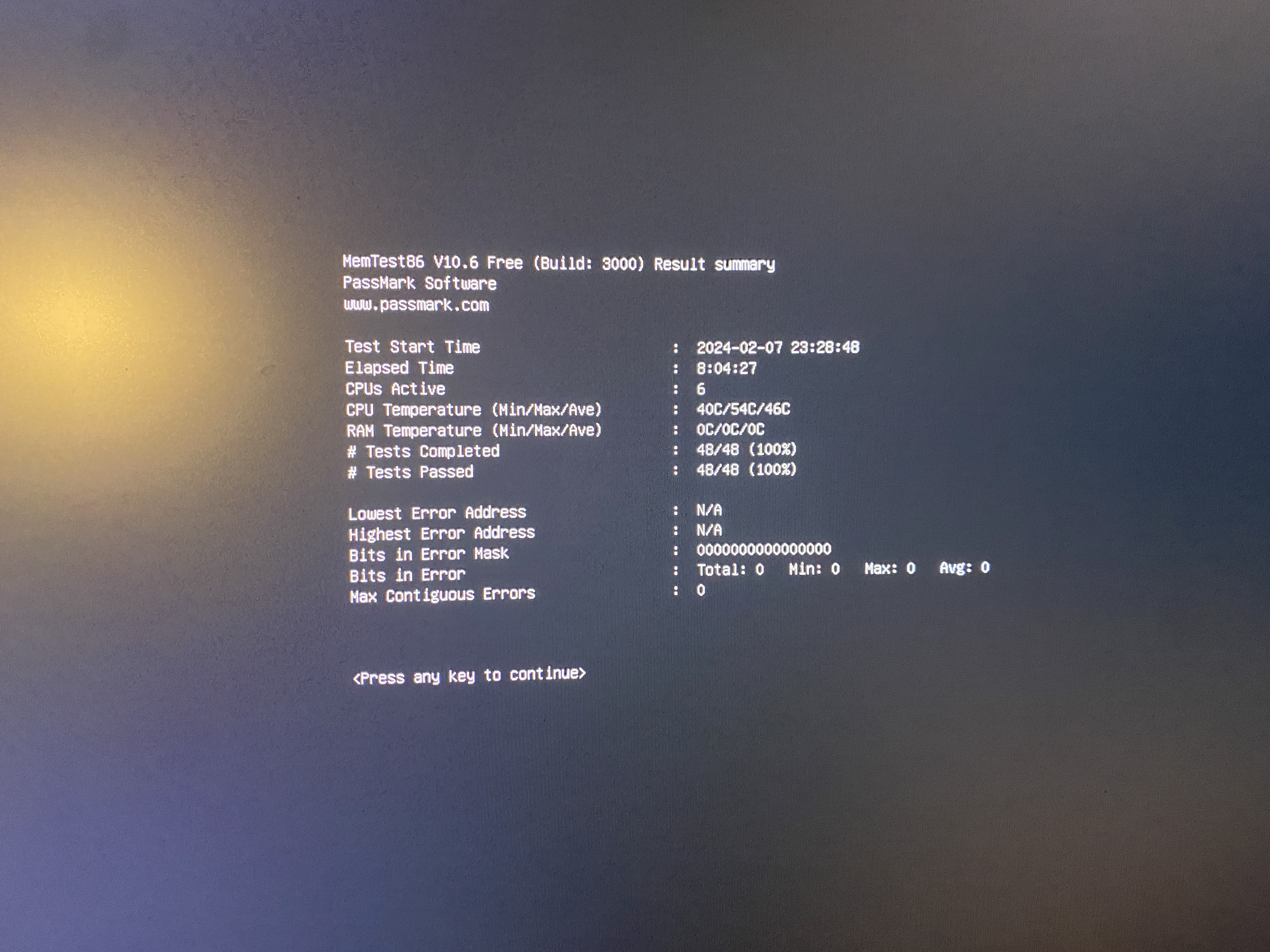

Unraid driver is crashing, this is almost always a hardware issue, start by running memtest.
No issues since last boot; took it offline yesterday to run a memtest. I'll upload the full report later (don't have the memtest USB with me) but the memory checks out. (Possibly vulnerable to high frequency row hammer bit flips, but no errors).

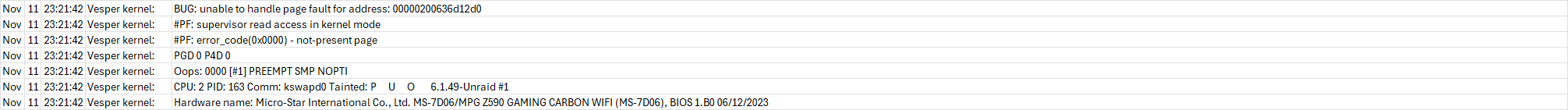

I keep seeing posts re: intermittent crashing. These folks are lambasted by people saying it isn't a problem, but then why do the posts keep coming? Anyway. I am not a developer, and I have inconsistently downloaded and examined my syslogs, but they do consistently show BUGS as the last timestamp before the system goes unresponsive.
E.g.:
Nov1123:21:42Vesper kernel:BUG: unable to handle page fault for address: 00000200636d12d0
Nov1123:21:42Vesper kernel:#PF: supervisor read access in kernel mode
Nov1123:21:42Vesper kernel:#PF: error_code(0x0000) - not-present page
Nov1123:21:42Vesper kernel:PGD 0 P4D 0
Nov1123:21:42Vesper kernel:Oops: 0000 [#1] PREEMPT SMP NOPTI
Nov1123:21:42Vesper kernel:CPU: 2 PID: 163 Comm: kswapd0 Tainted: P     U     O       6.1.49-Unraid #1
Nov1123:21:42Vesper kernel:Hardware name: Micro-Star International Co., Ltd. MS-7D06/MPG Z590 GAMING CARBON WIFI (MS-7D06), BIOS 1.B0 06/12/2023

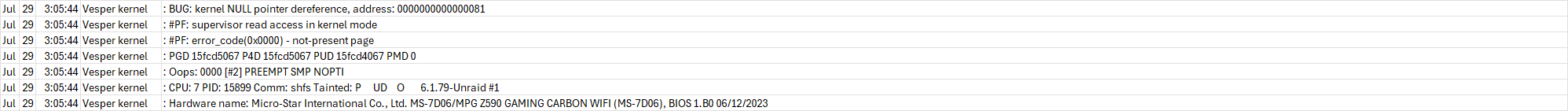

and
Jul293:05:44Vesper kernel: BUG: kernel NULL pointer dereference, address: 0000000000000081
Jul293:05:44Vesper kernel: #PF: supervisor read access in kernel mode
Jul293:05:44Vesper kernel: #PF: error_code(0x0000) - not-present page
Jul293:05:44Vesper kernel: PGD 15fcd5067 P4D 15fcd5067 PUD 15fcd4067 PMD 0
Jul293:05:44Vesper kernel: Oops: 0000 [#2] PREEMPT SMP NOPTI
Jul293:05:44Vesper kernel: CPU: 7 PID: 15899 Comm: shfs Tainted: P     UD    O       6.1.79-Unraid #1
Jul293:05:44Vesper kernel: Hardware name: Micro-Star International Co., Ltd. MS-7D06/MPG Z590 GAMING CARBON WIFI (MS-7D06), BIOS 1.B0 06/12/2023
