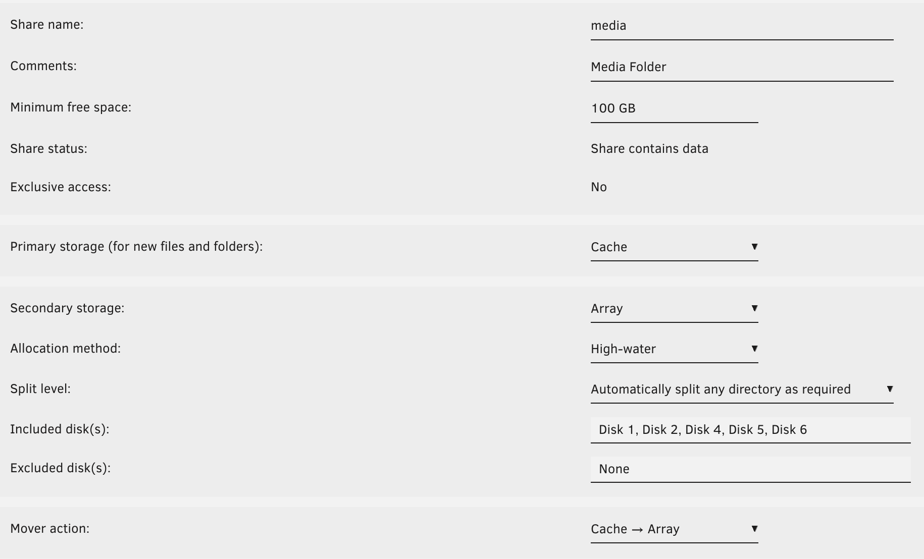

- The mover running, moving from cache to media share in disks 1,2,4,5,6 (media in with high-water conf, screenshot attached)

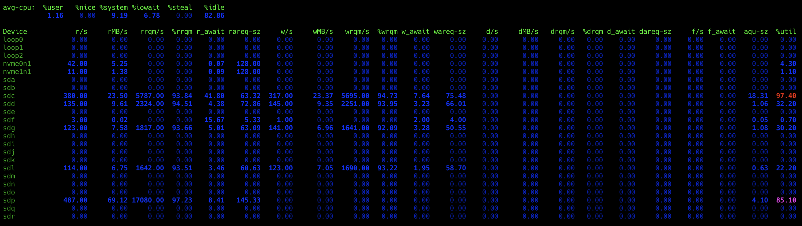

I don't have any special io-wait, maybe this can help:
169396555_Screenshot2023-12-13at12_28_59.thumb.png.dd49892dcd1d0e02dbe44231f8a2a83b.png
littleboy-diagnostics-20231213-1219.zip
Edited by skler
Any time there are writes going on to 2 or more disks turbo write won't work and write speed will be much slower because parity is being updated at the same time for all disks, you can only test turbo write if writing to a single disk.
18 minutes ago, skler said:
When diagnostic was done there were:
As usual with HDDs you never want to do 2 things at the same time, it'll always be slower than doing them one after the other.

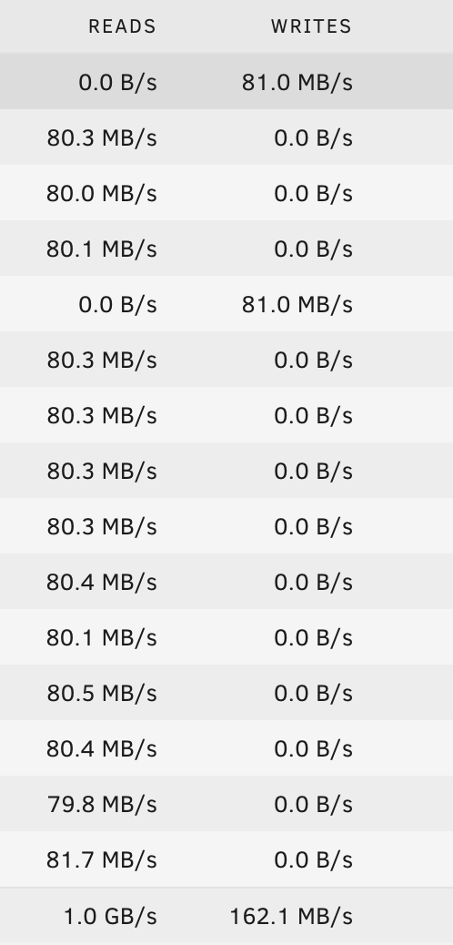

it is an acceptable result, but there is something I can do to improve it? the disk can write at 230mb/s
