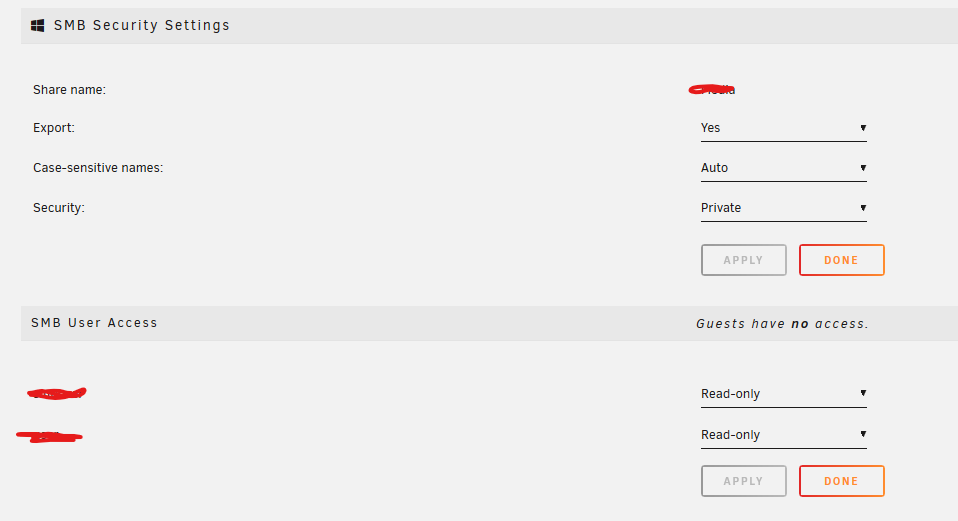

Click on the    SHARES    tab on the GUI.   Then click on the blue share name of the share you can access.   Do a screen capture of this portion of the that screen as shown below. (I have blacked out the sensitive information.)
Now for do the same for one of the shares that you can't access.

Thanks for responding, this is the screenshot, also with the sensitive data blocked in red (with red text to indicate what used to be there)
The thing is though; I can access the share and I have access to one of the four folders in the share, so as far as I understand it, it cannot be my credentials or the Read/Write setting here.

That screenshot was from the share you can access?   Can your brother access the other shares or is he also denied access to those shares?
