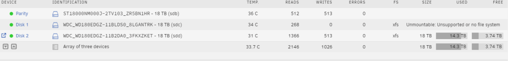

hey, so I upgraded the case on my server as the old one had no airflow or drive bays before i shut the server down i stopped the array and did a clean shutdown.
when I've rebooted i assume I've put the drives back in the wrong port so when unraid loaded it said that my parity and disk 1 is un readable because it mounted them backwards.
I went into main with the array down and tried to move the drives to the correct place and the disk 1 shows as unmountable any ideas how to fix this? everything was fine until shutdown and reboot
Let me know if you  need any more screenshots thank you for the help so far
Unraid doesn't care about ports. It identifies and assigns disks by serial number
