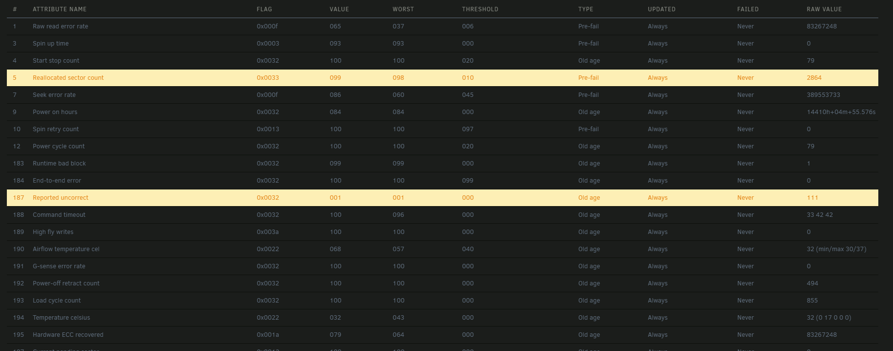

November 18, 20232 yr I've had some dard drive issues latly and I finally got my parity drive replace and one of the two failing drives replace thanks to some awesome folks on discord unafical unraid. I knew the drives where failing when I starting having folder access iisues. I'm still having those issue. Hoping once the rebuild finished that will be fix but i'm doughtful. Not even my radarr and soarr are able to access the folders. does anyone have any suggestions on how I can resolve this please Edited November 18, 20232 yr by ltworf13
