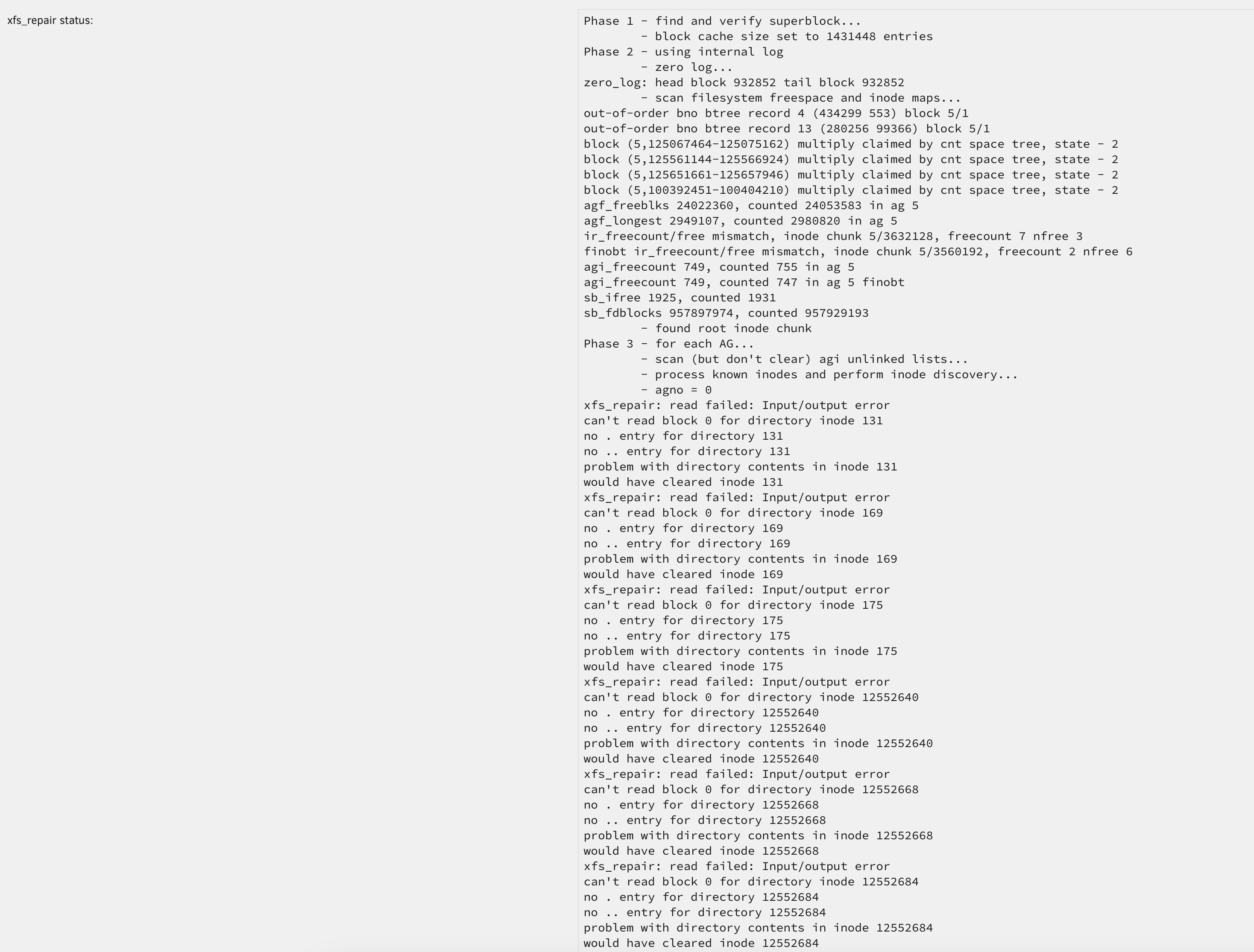

This is what I see when I run xfs_repair in the GUI
966707820_Screenshot2023-11-19at13_58_14.thumb.png.9de0aecf2d8ab003599aaf20eee1ad31.png

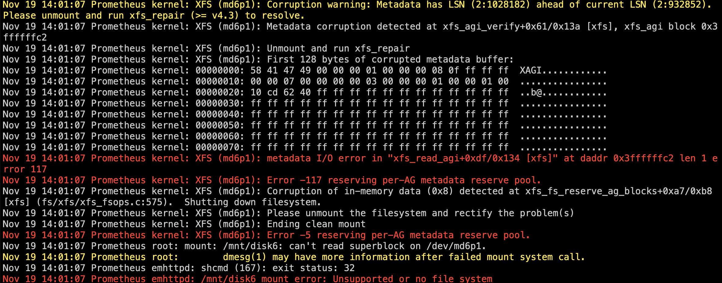

And this is the error I get on disk 6 when I start the array
1667393390_Screenshot2023-11-19at14_01_31.thumb.png.c9e7b30c9a55b57a3612a7e559dc81cf.png
Running using the GUI again but without -n.
