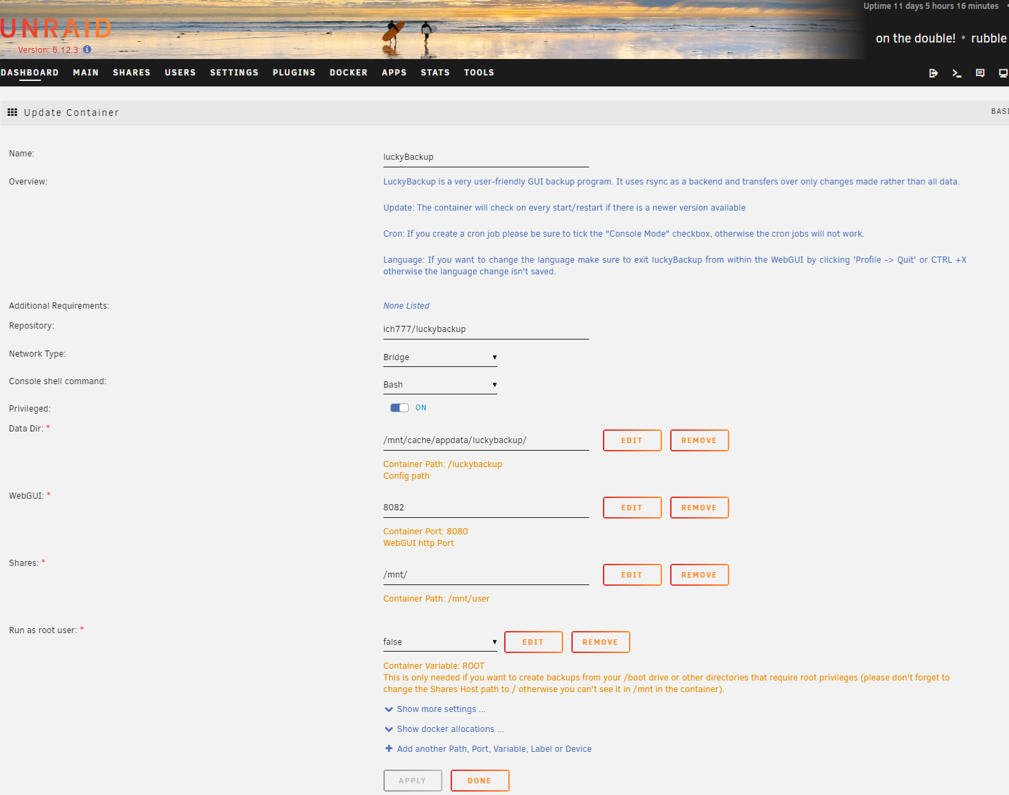

I'm trying to use Luckybackup in setting up an rsync connection with some recursive folders on my array to an external USB drive mounted via Unassigned Devices. I can send the files to a different spot on the array no problem, but when trying to write to the external USB, I get write errors. Not sure if I'm mounting it wrong, or setup the Luckybackup template incorrectly?
Luckybackup Docker > Console can read and write to the USB drive.
You can see I've passed the /mnt/ to the Docker. Paths are relative in the luckybackup Docker
source
/mnt/user/user/nextcloud/username1
dest
/mnt/user/disks/TOSHIBA_EXT/username1_nextcloud
