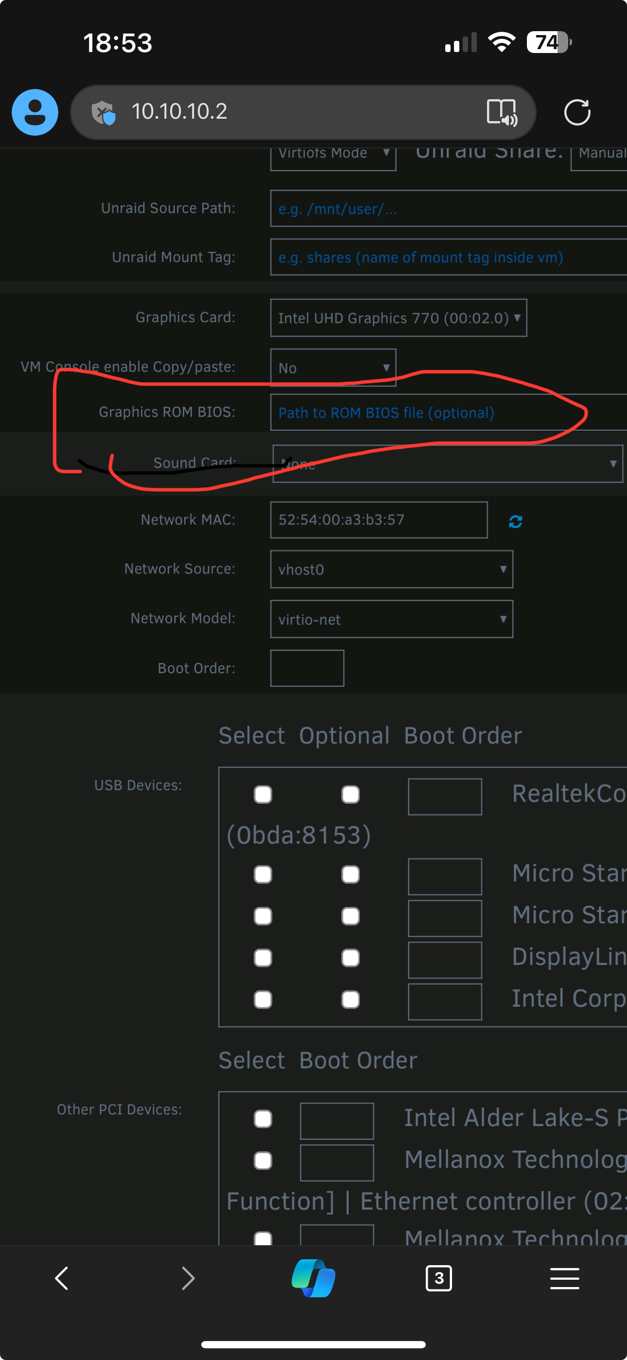

I think you need an VBIOS for those Kepler Gen GPUs. Its been a while but then it should work.
I'm passing through the most current VBIOS from techpowerup after removing the header. Do I need to actually flash it to the card? That may prove difficult, as I don't have an available windows PC.
No just add that vbios in this section. No Flash needed.
