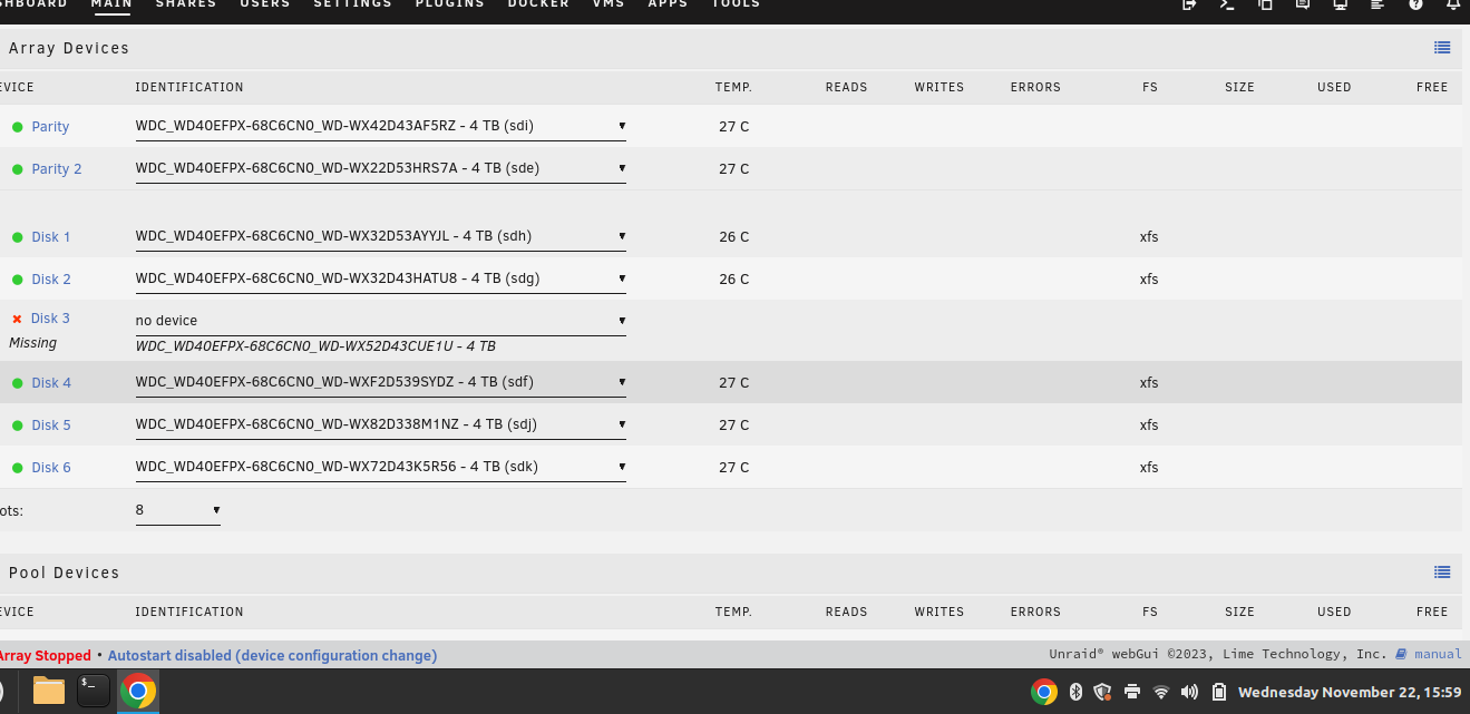

I've got 8x WD Red 4tb installed through a HBA card - setup (hard drives & HBA brand new 1 month ago) has been working flawlessly up until now. I just noticed the machine shutdown, I booted it up and now Disk 3 is missing, screenshot here. Can I do anything within Unraid to fix this?

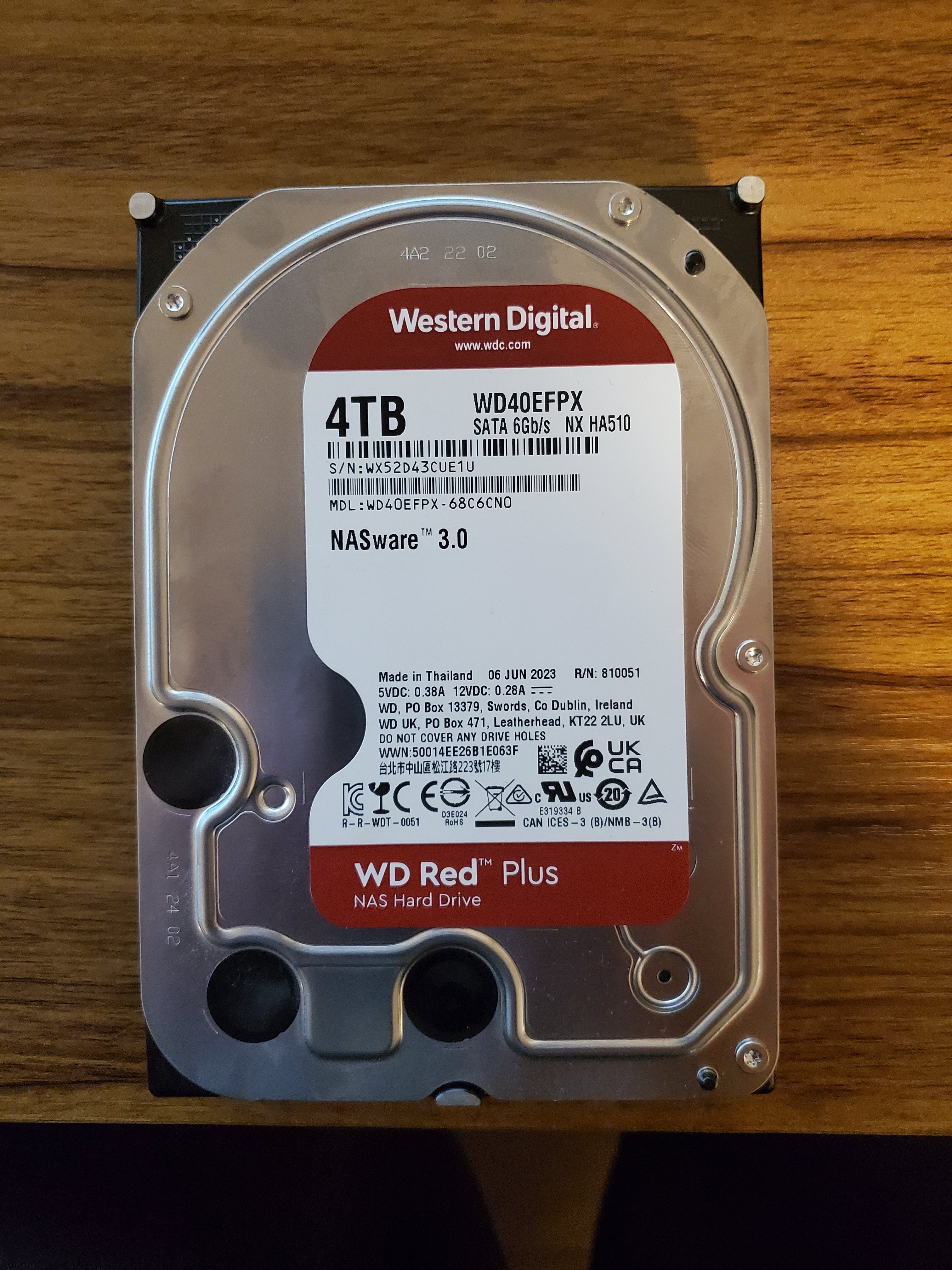

Update: I physically removed the disk and inspected it (and sniffed it for burning smell - nothing)

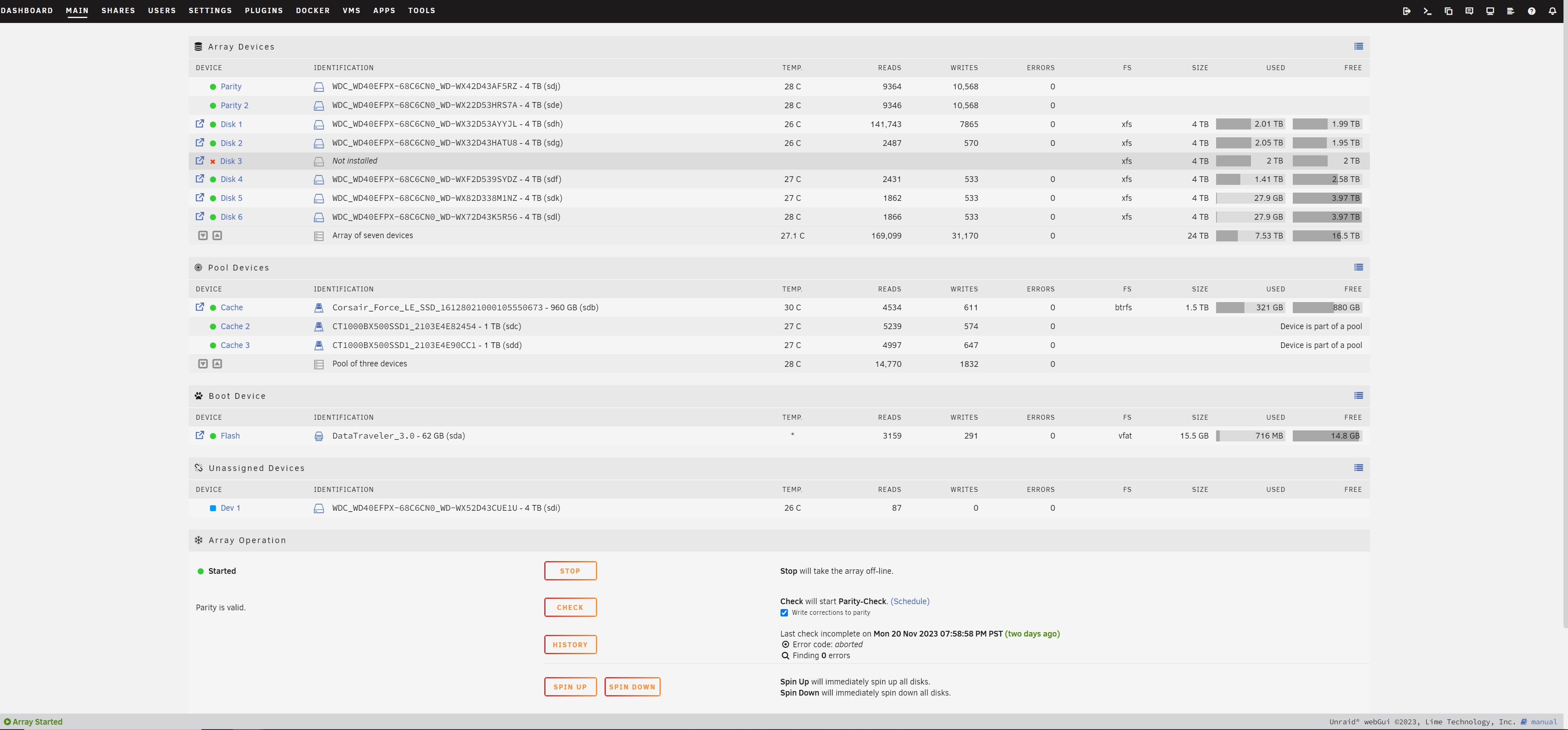

Re-installed the disk; Unraid recognized it, but was not auto added to its previous position (Disk 3)

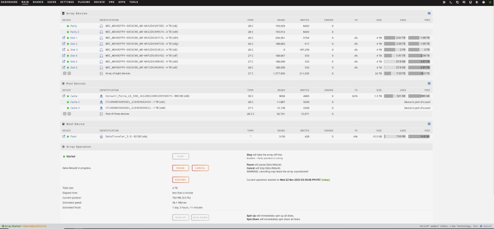

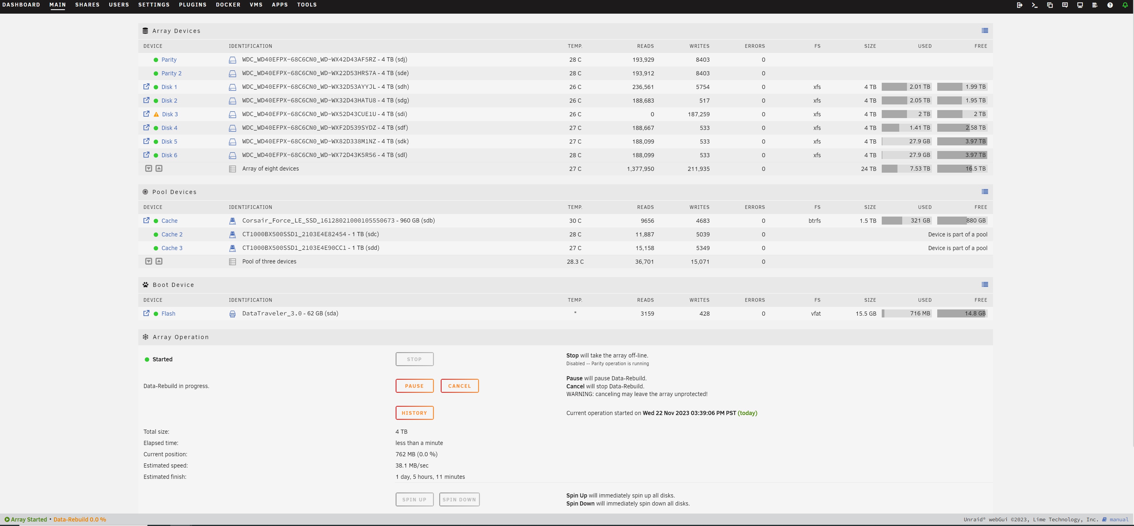

Manually added disk to array set to Disk 3; Unraid rebuild started
1. I dont know what caused the disk to just disappear
2. I dont know why the disk became recognizeable when I reinstalled it
3. I dont know why the disk is recognizeable but lost all data? and then needed to be rebuilt from parity

That is SOP when a disk goes missing...  You have to rebuilt the disk because the virtual disk (constructed by calculating its contents via the parity operations) will be updated with any changes to the disk's contents.)
