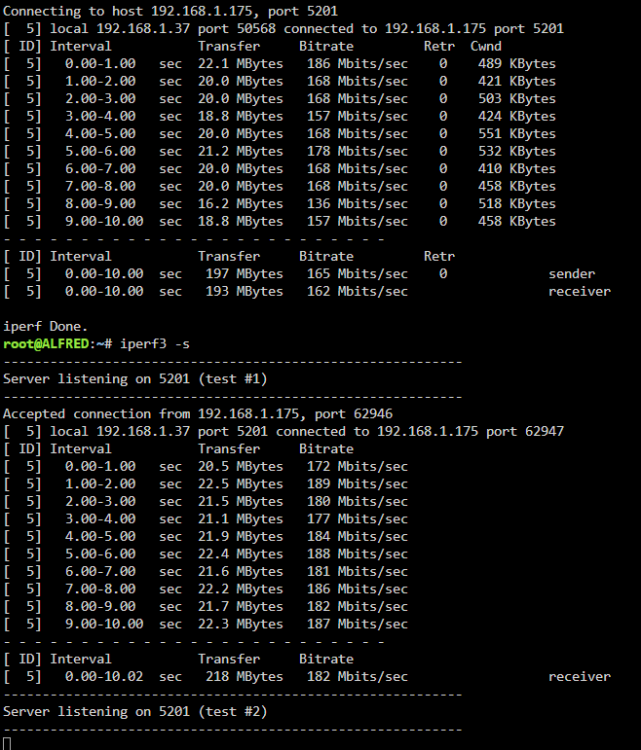

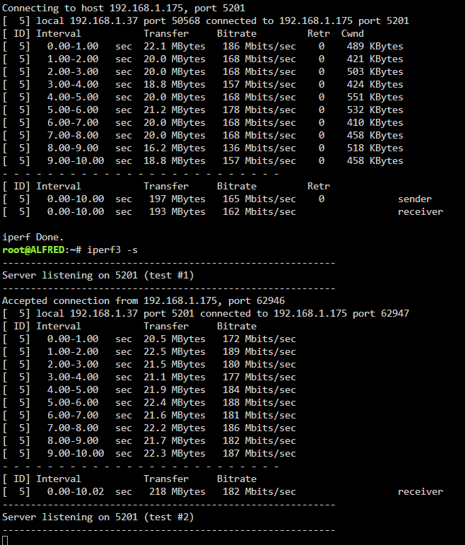

Ran iperf, and Bandwidth only showing between 168 to 181 Mbits/sec.
How do I improve this?

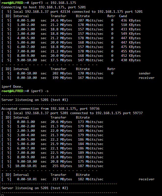

No success unfortunatly :(
Just done a both ways ipref and still the same with the Plugin and a New Cat5e Cable - 4 pairs.

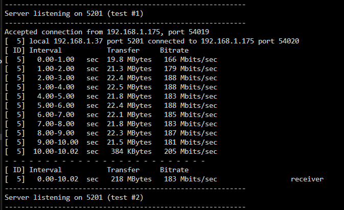

Turned bridging off as per the below, but still no change. @JorgeB any ideas?
ipref results both ways with Driver Plugin and Bridging off.

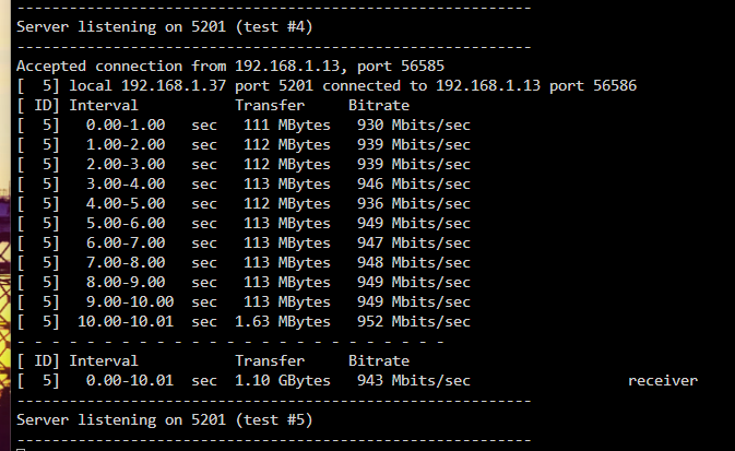

Changed cable and much better!
