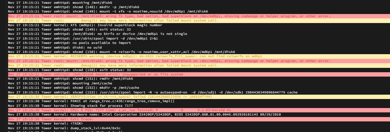

System log shows
Nov 23 18:52:38 Tower flash_backup: adding task: /usr/local/emhttp/plugins/dynamix.my.servers/scripts/UpdateFlashBackup update
Nov 23 18:55:22 Tower nginx: 2023/11/23 18:55:22 [error] 8765#8765: *6037 upstream timed out (110: Connection timed out) while reading upstream, client: 192.168.0.108, server: , request: "POST /update.htm HTTP/1.1", upstream: "http://unix:/var/run/emhttpd.socket:/update.htm", host: "192.168.0.225", referrer: "http://192.168.0.225/Main"
I'm unable to get a diagnostics log as I just hangs and the dashboard shows the CPU's slowing one core at a time maxing out.
If I restart the server ( Auto Start Disabled ) the server boots, until an attempt to start the array,
I've attempted to remove a disabled drive which appeared to be fine but still the array refuses to start.
Any ideas would be much appreciated.
tower-syslog-20231123-1904.zip DIagnostics.zip

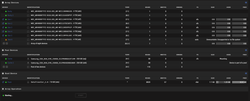

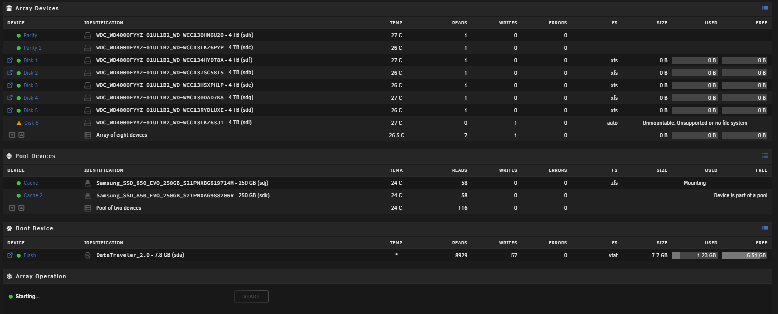

So a little further but not sure if its a good thing.
In "Safe Mode" I've been able to start the array, however the "Cache Pool" which is a pair of SSD are showing as "Unmountable disks present" which were a zfs pool hosting my appdata, domains, isos and system.
So now worried I've lost all my dockers etc that had been working flawlessly.
Any ideas would be very gratefully received. Thanks
