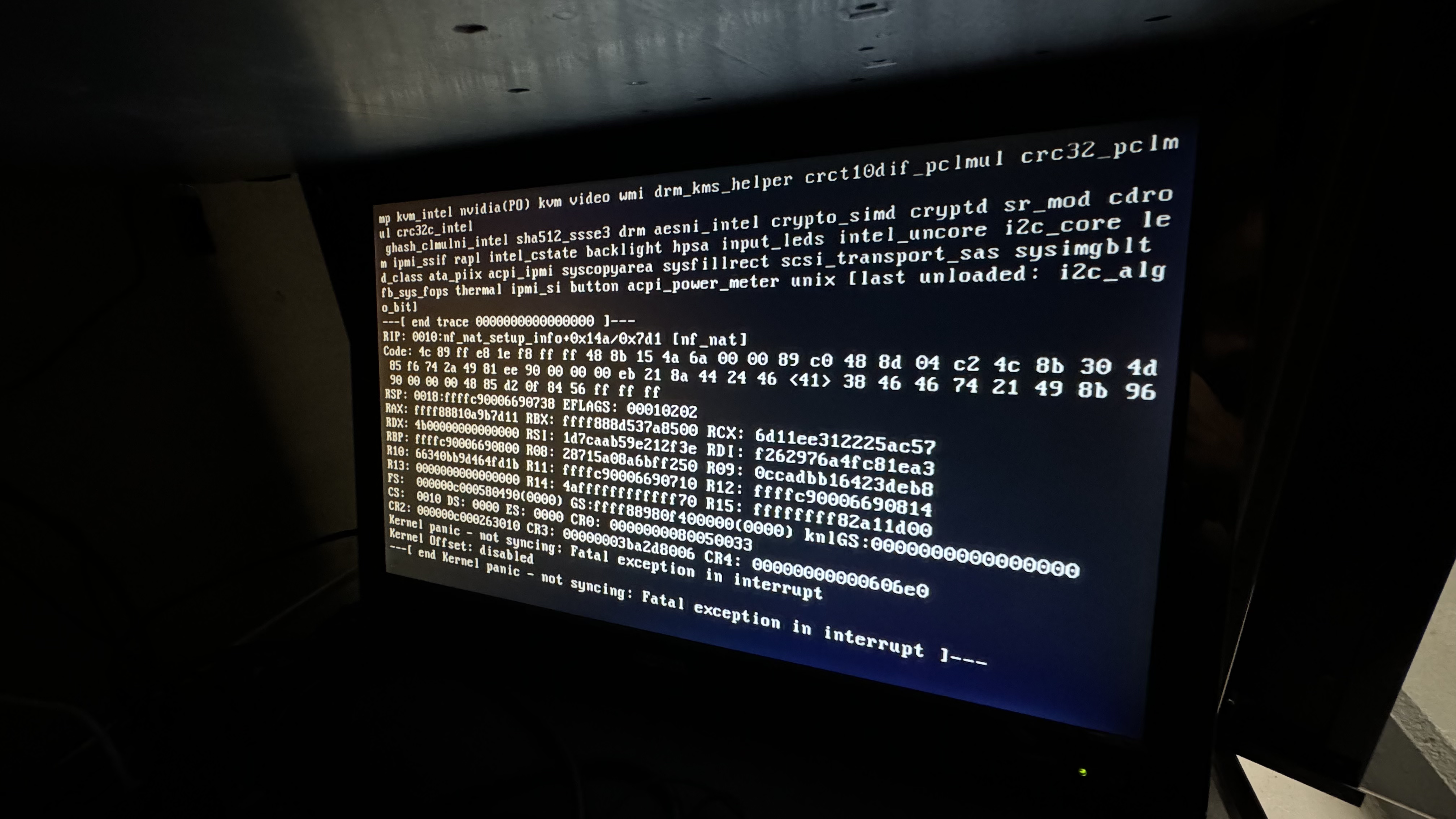

Hello, I seek you help because my UnRaid did 2 Kernel panics this night and I cant figure out from where they come from.
First was in the start of the night, second was at 3h33 in the morning.

Forget that for now, the issue is already visible in the after boot log:
Nov 24 09:25:26 UnRaid kernel: macvlan_broadcast+0x10a/0x150 [macvlan]
Nov 24 09:25:26 UnRaid kernel: ? _raw_spin_unlock+0x14/0x29
Nov 24 09:25:26 UnRaid kernel: macvlan_process_broadcast+0xbc/0x12f [macvlan]
Macvlan call traces will usually end up crashing the server, switching to ipvlan should fix it (Settings -> Docker Settings -> Docker custom network type -> ipvlan (advanced view must be enabled, top right)), then reboot.

Yes I saw that someone else had this problem and that you pointed at the same problem, I switched ipvlan this morning while troubleshooting. I'll keep you updated if this was the problem.

Don't forget to reboot after the switch.

This was the problem. Had no crash since I changed it. Thx
