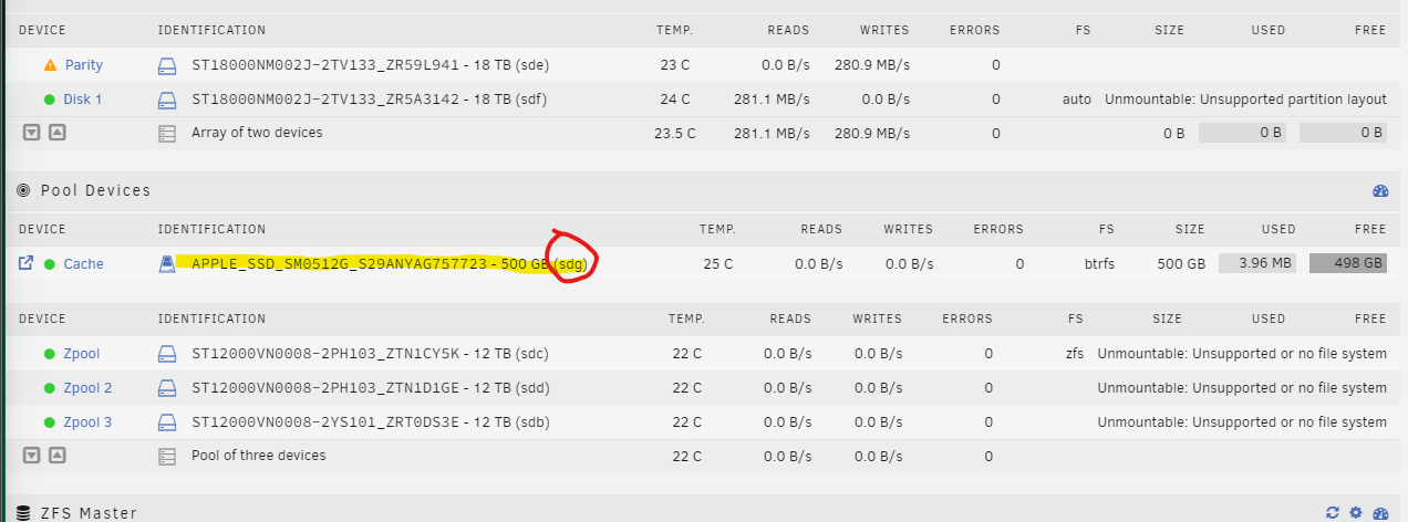

Hoping to get some expert advice here. I created a New Config under Tools to swap out a single drive that was in my Array Devices. I swapped out this single drive to two new, 18 TB drives.
I already had a running Zpool with three 12 TB drives formatted as zfs. The New Config was started and the two 18 TB drives are expectedly reporting Unmountable: Unsupported partition layout as they are new drives. However, the big issue is that my active zpool now shows as Unmountable: Unsupported partition layout.
It would be great to not have to reformat the zpool as I have data I really would like to not lose. Thanks in advance!normasraid-diagnostics-20231126-2031.zip

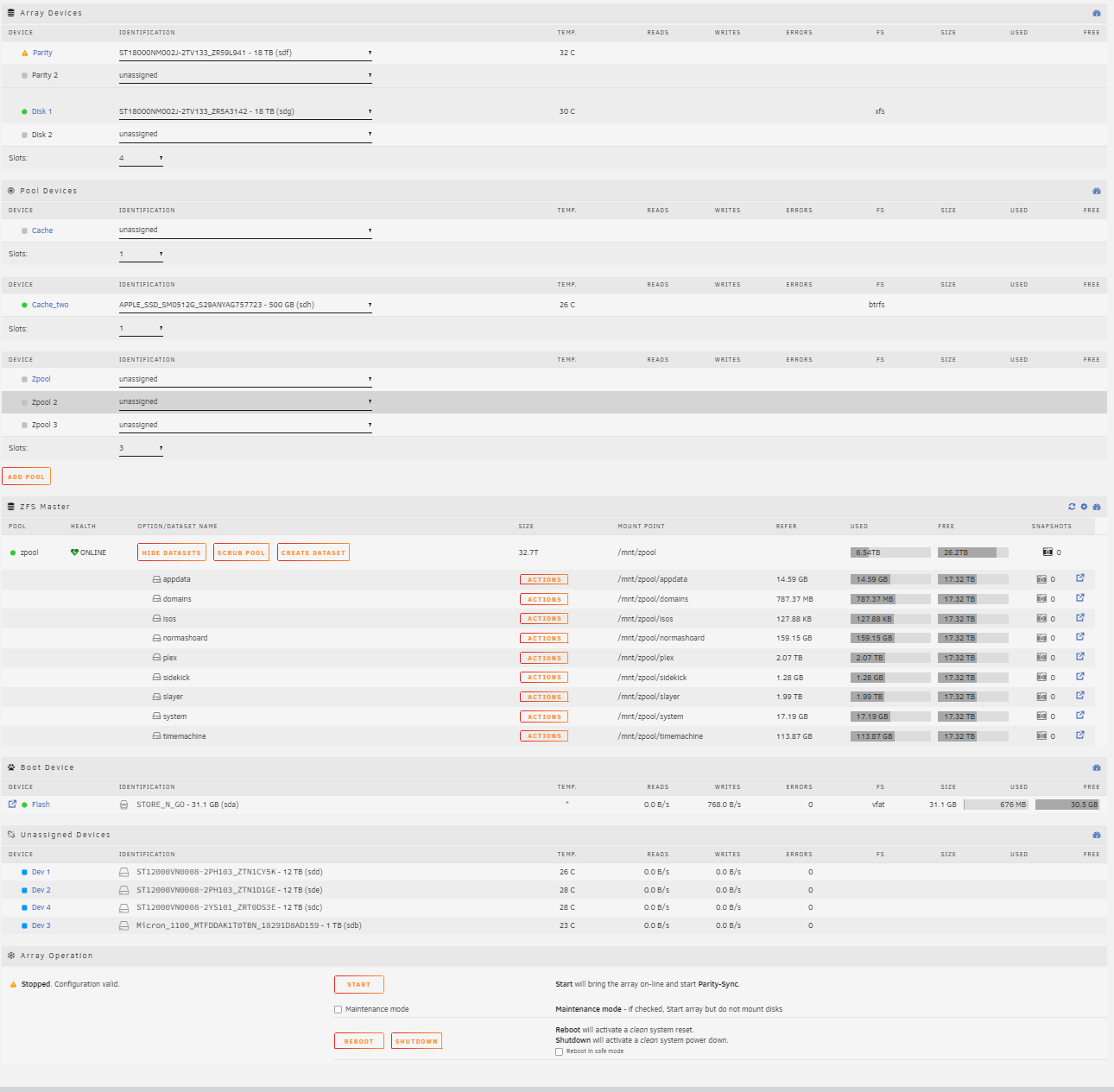

I had a cache drive used before, could that be it? It looks like my cache drive got relabeled as sdg. image.thumb.png.c2939ea24071879ab4ea5c7ff3d23290.png

I noticed the drive sdg is different that the output of the cache text above with sdb. opened up my server and noticed that drive had become unplugged. plugged it back in and the correct cache is in that slot. new zpool import results below

    • "Yes I want to do this" box is not present when array is stopped, it only shows up once I start it. Then it shows up due to my new drives under a standard array actually need formatting, did this then went to next step
    • screenshot when array is stopped
    • screenshot when array is started

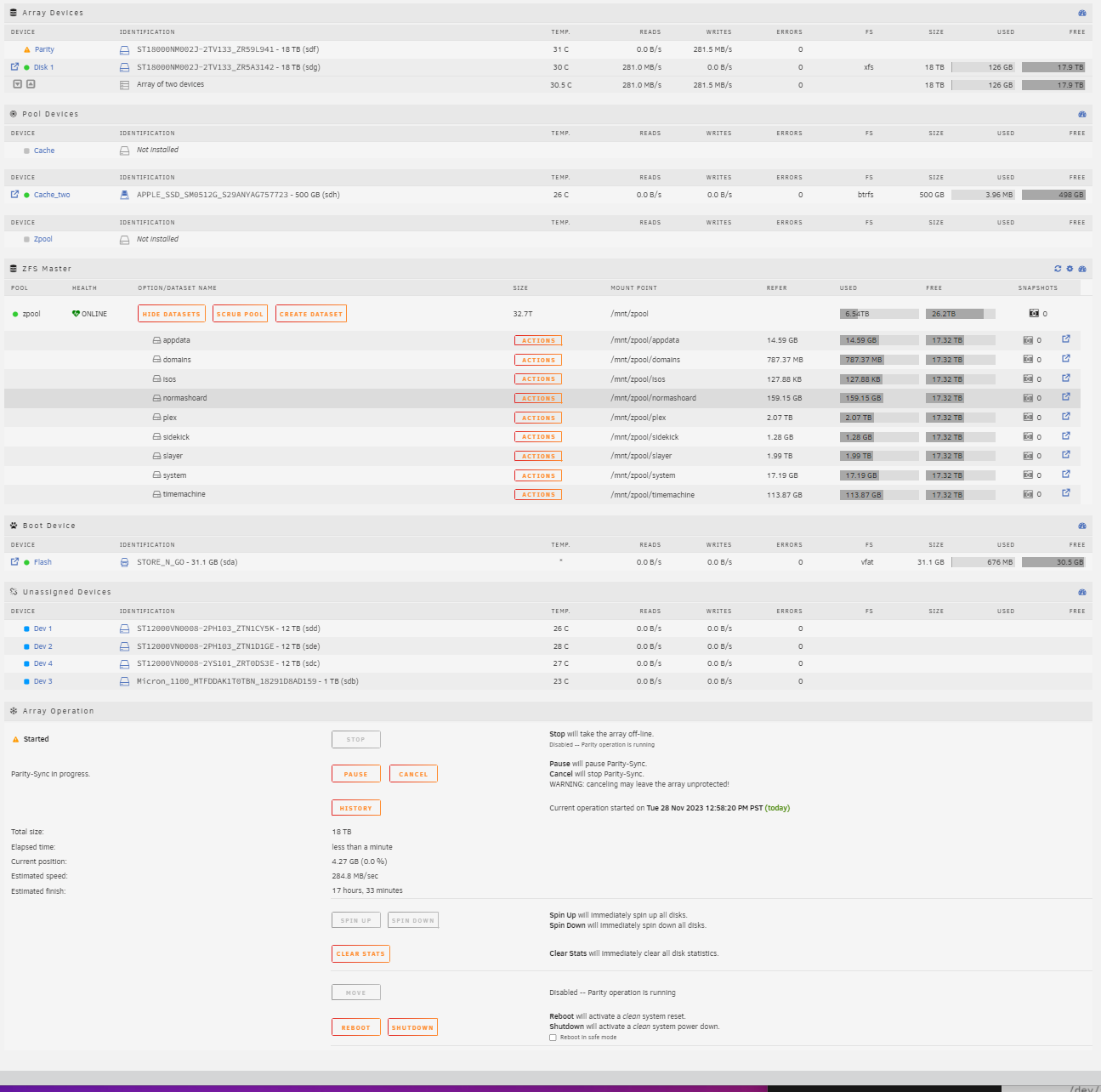

  • stop array
    • clicked stop array after stopping parity sync for the drives in the main array
  • re-assign all pool devices, including the new vdev(s), assign all devices sequentially in the same order as zpool status shows, and don't leave empty slots in the middle of the assigned devices.
    • added all zpool drives back to their orginal slots and the cache drive via the GUI
  • start array
    • started array in maintenance mode and it doesnt show Unmountable: Unsupported or no file system but when out of maintenance mode it shows up again
- I feel like I am missing something simple here? Do I need to change anything under the device settings? I have been forcing it to pick zfs as the file system instead of auto and setting the drives to never spin down to fully utilize the benefits of zfs.
- Could it also be the cached drive? Do I need to remove it from the zpool entirely? Then add it back? If so, how do you do that?
normasraid-diagnostics-20231128-1513.zip
Edited by norma_567
