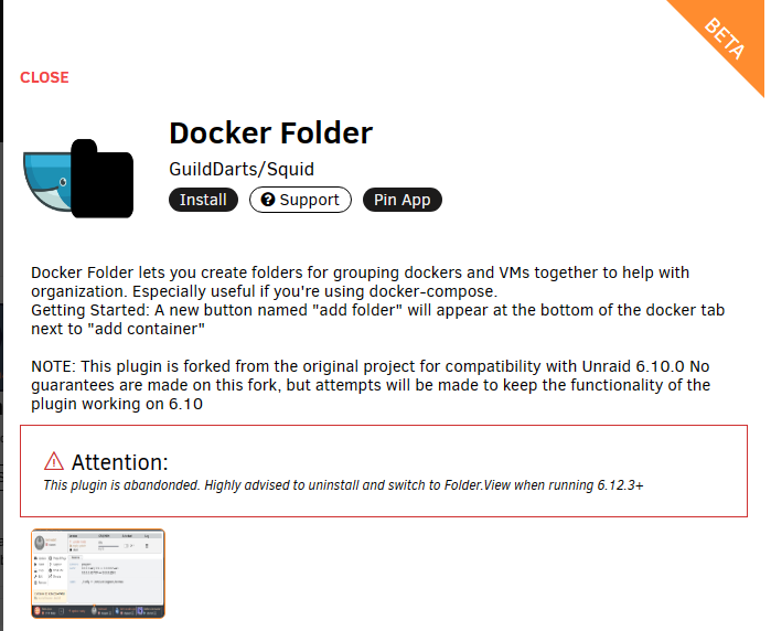

I ended up updating the 'Folders' app and use 'FolderView' instead.
I also updated to 6.12.6 which didn't affect the docker issue.
Once I installed FolderView, I was able to mange the containers 'normally'. I could start, stop and pause and I can also create folders once again so I can organize my containers.

Hey. I had a similar issue.  It was bugging the heck out of me.  I found had to just remove the installed app below(Docker Folder).  I hope this helps someone else or even me if I forget in the future:)
