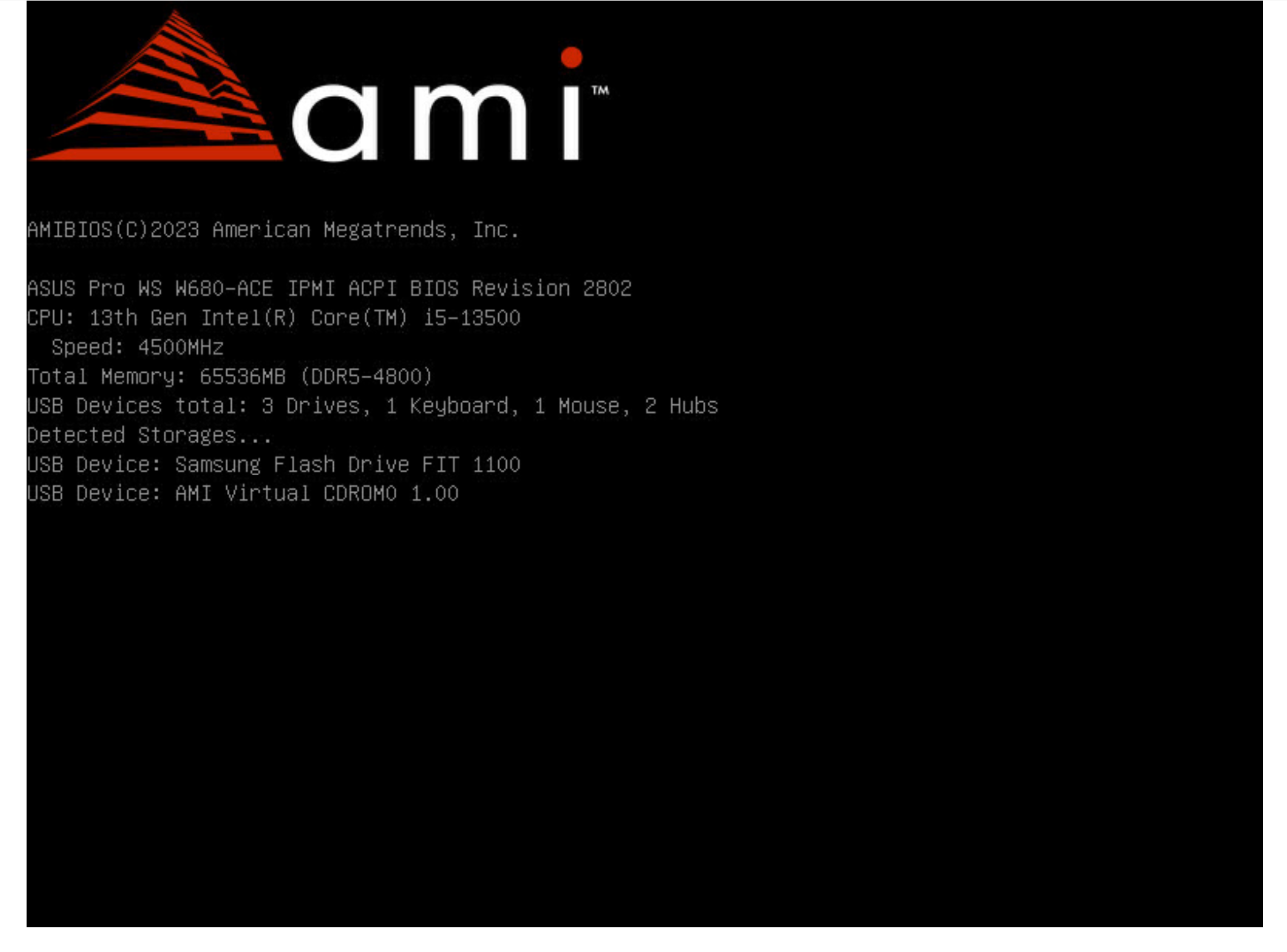

I updated the BIOS to 2802 today from 2305 as part of some prep to update from 6.11.5. When I do a shutdown via unraid, on the next power on, all the drives are no longer detected in POST. I have to powerdown again via IPMI then everything behaves itself. Warm restarts are ok.
I'm posting just incase anyone uses this board and has the same issue and if anyone has any ideas why this might be happening (ACPI settings?) as the update blew away my BIOS config so I may have forgotten to set something correctly. This is repeatable.

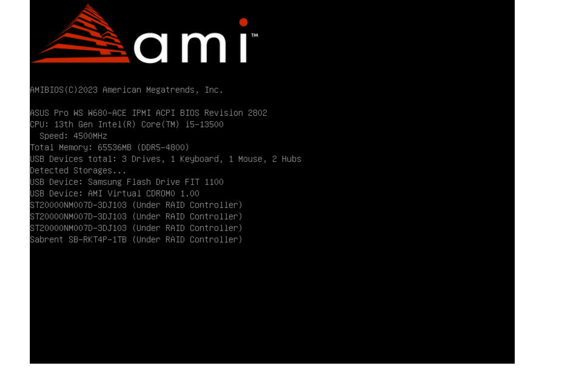

Normal....
Not normal...
