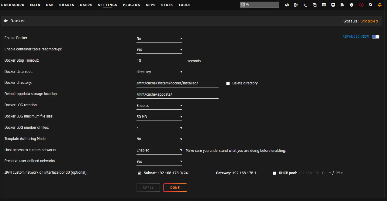

Hey, i guess i got an similar Problem.. but i cant find the Switching Part in Docker Settings anymore..
it wont show up... what am i doing wrong :D
There is no Setting anymore. i followed the instructions mentioned in the Release notes.. becouse i got also problems with only IPVLAN..
Is bridging enabled for eth0?
Yes infiguerd it out.. thanks for the hint with restart.. didn't do that
