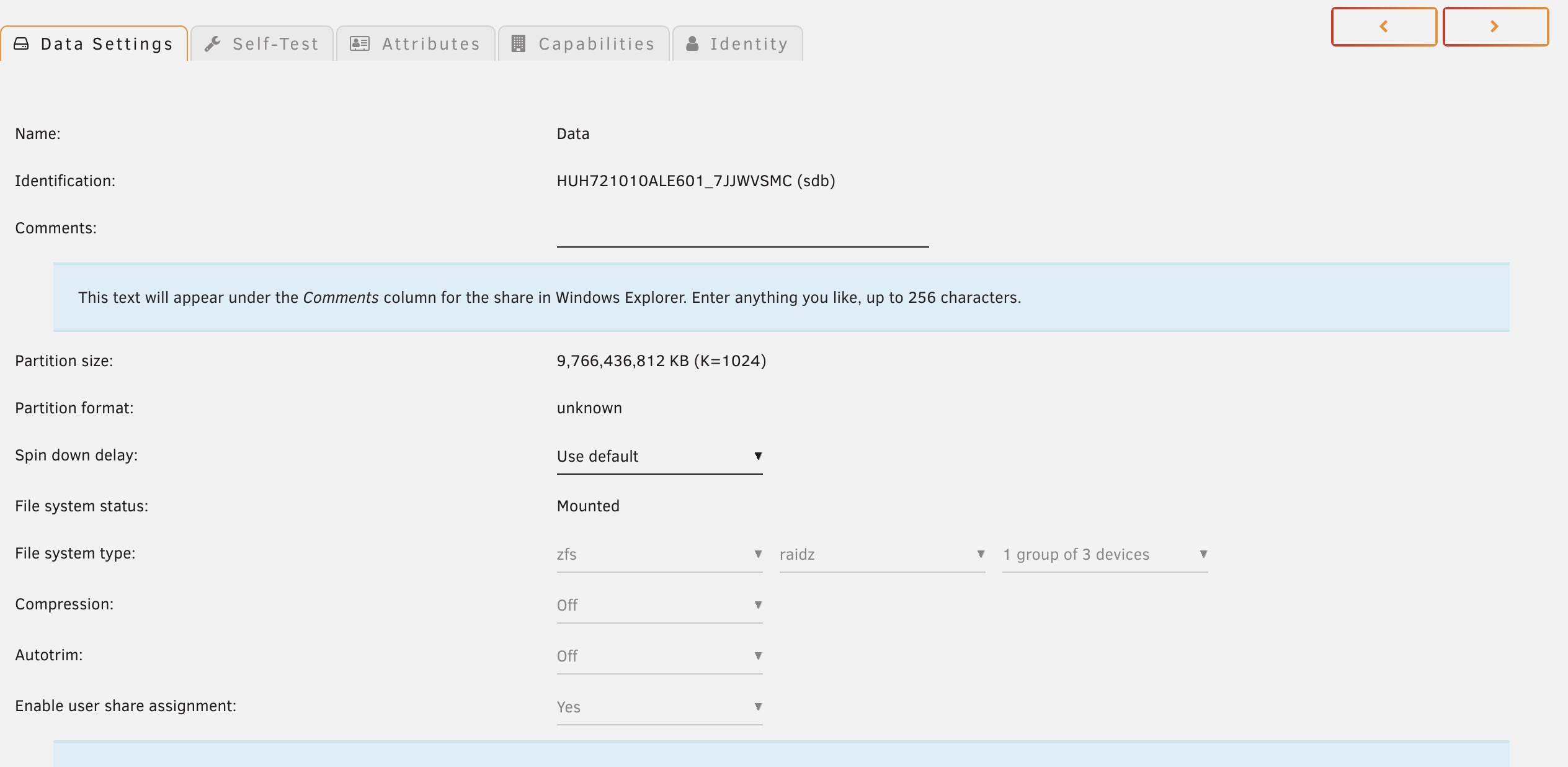

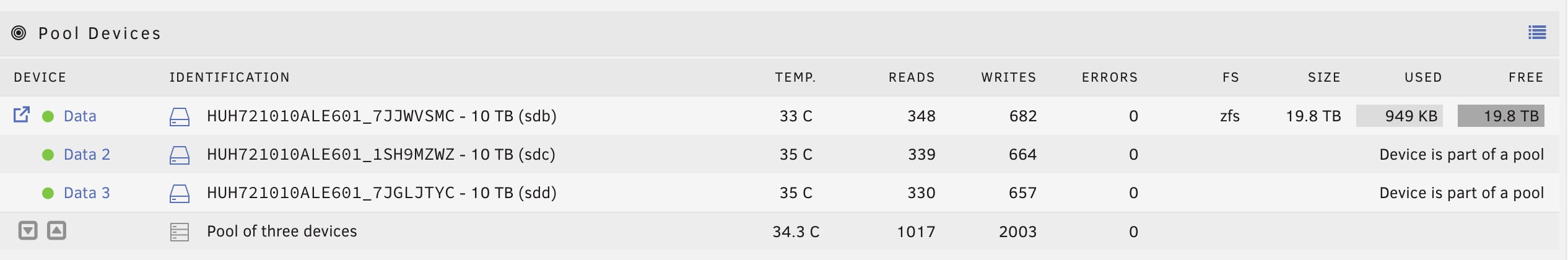

Thanks (¿Gracias? Por tu nombre pareces español ;) ) Yes, I've done that and the new pool seems to be exactly what I was looking for. There's not much details about that: it shows that the pool with three 10TB drives has an available storage of 19.8TB, zfs filesystem and three drives, so I guess it's running with RAIDz1 as I wanted.

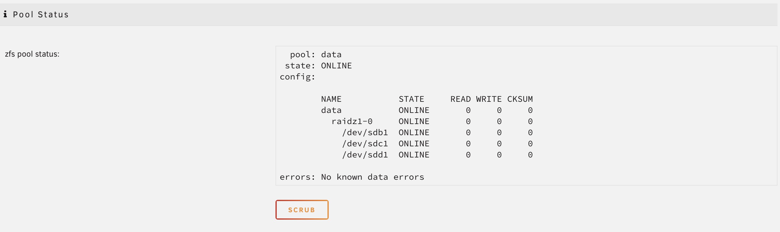

You can click on the first pool device, then scroll down to the zpool status section and you'll see the pool config, but based on the stats it's raidz1.
I see. You're right, on the first part of data settings it shows "raidz", and then, down there, the pool status shows that "raidz1-0", so everything seems perfect.
