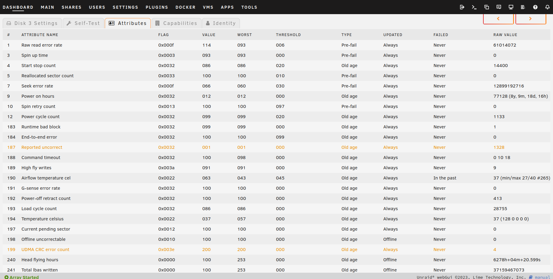

Edit: directly after writing the post I noticed that there are some SMART errors on the device. I have attached the error log and a screenshot of the smart attributes. I did a SMART short self-test which completed without error.
