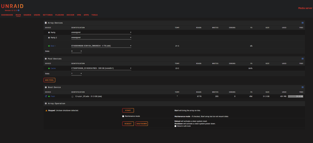

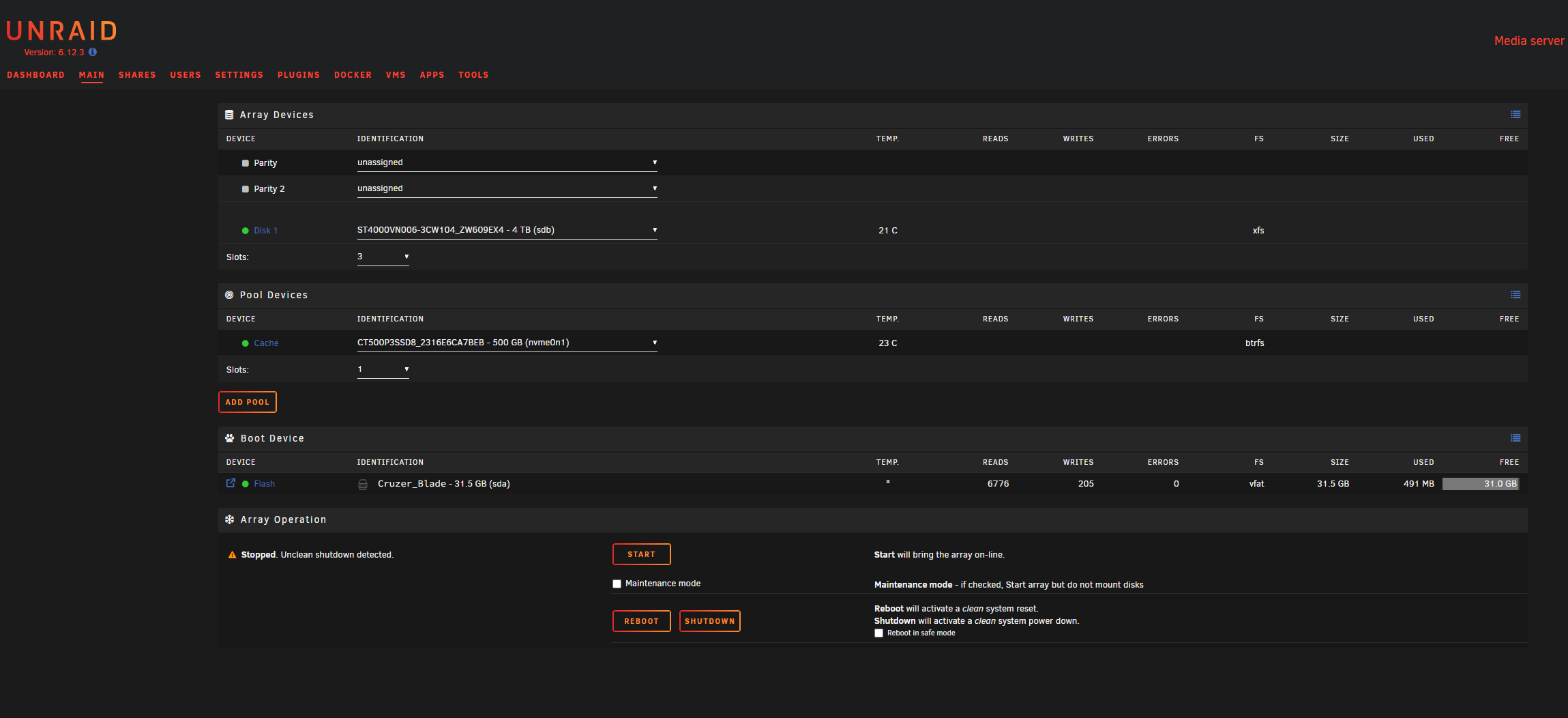

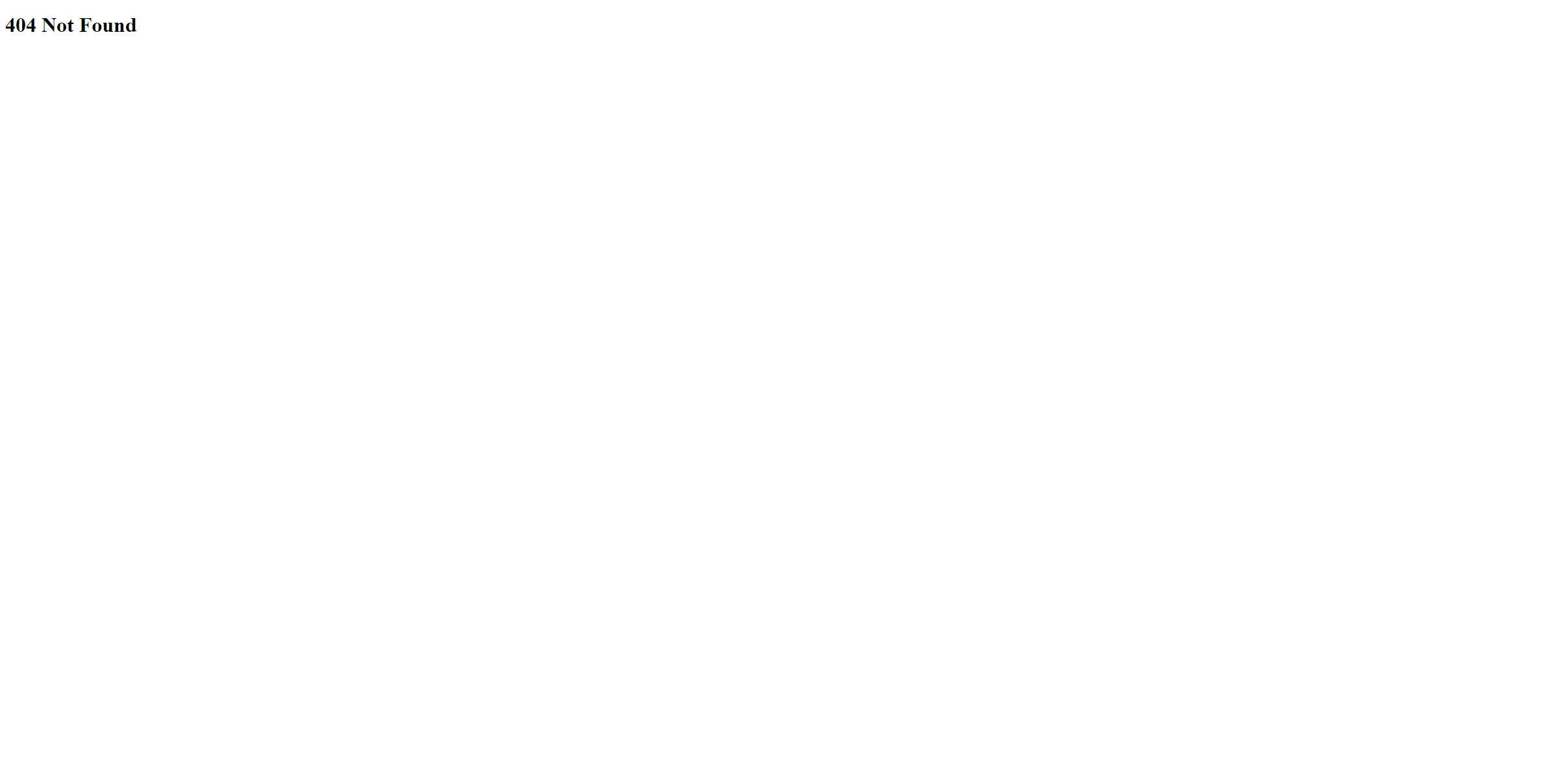

I am having some trouble starting my array, it will let me log into the Web Ui when turn it on, but when I press start I will say 404 Not found. I dont know if it helps but I have run a Read Check and it says that no errors where found and I have attached the logs, any help would be appreciated.
tower-diagnostics-20231130-2048.zip
Solved by JorgeB
Try booting in safe mode.
I booted it in safe mode and pressed start and it did the same thing.
Try using a different flash drive with a stock Unraid install, no key needed, that will confirm if it's a lan problem or a /config problem.
Just tried it and it has done the same thing.
Then you likely have a network problem, and possibly are not even connecting to the server GUI but a different device.
I have fixed it now I when into the network settings and changed the ip and it works now, thanks for the help.
