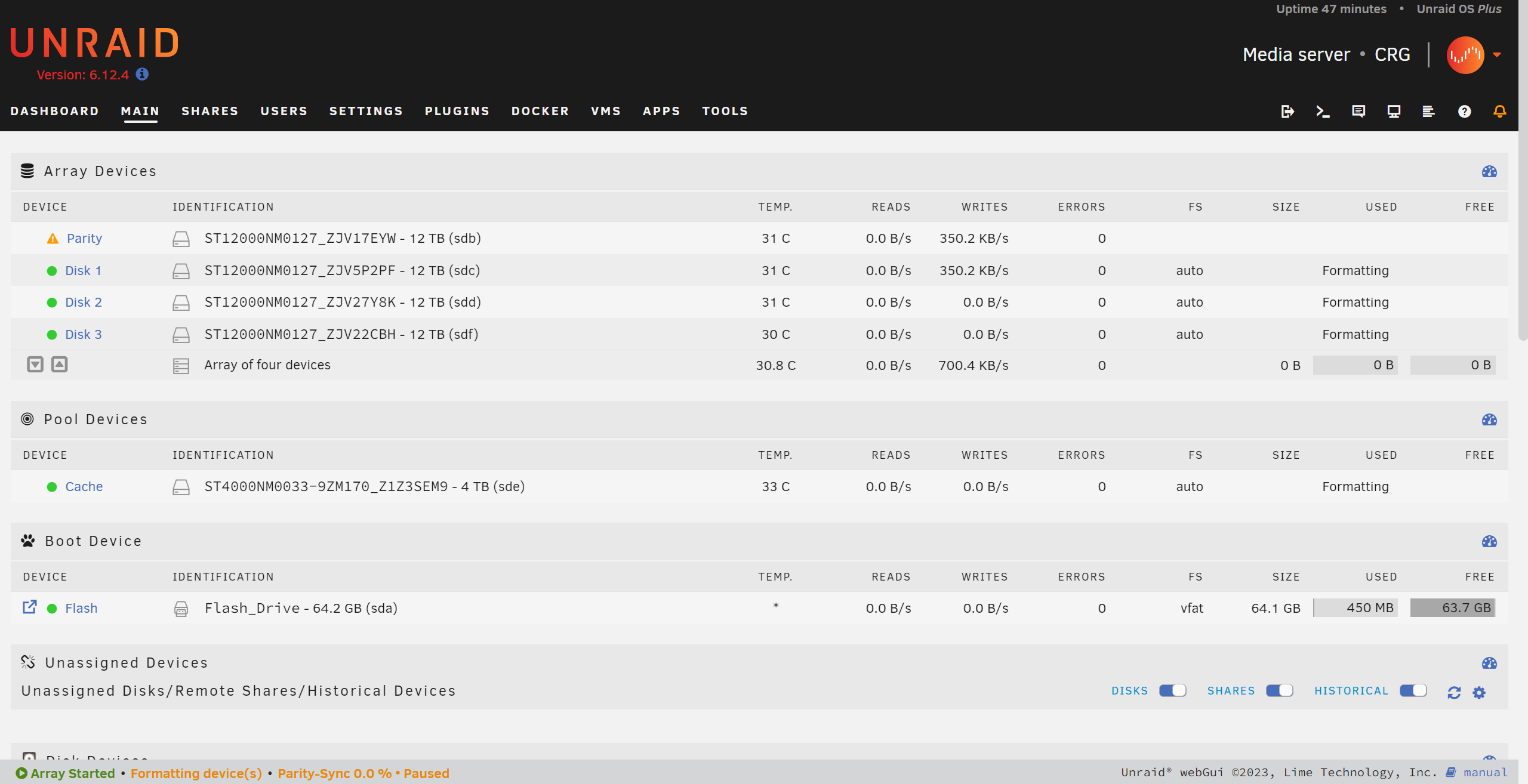

I'll try a different one as soon as I can I guess. After swapping the controller all read/write speeds are still very slow. I can't even get the disks to format to use the array
Post new diagnostics
