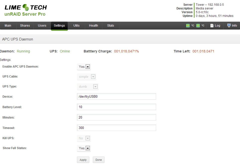

Hi all,
I built a custom table for a Back-UPS Pro 1400 that I've refurbished following these instructions:
(under "Simple Signaling Cable for "dumb" UPSes" - http://www.fatblokeracing.org/ApcupsdCableConfiguration.shtml)
The percentage value is way off and I'm wondering if anyone can help.
I've attached the cable to the unraid server via a usb to serial interface that I've used for years for other things. It was detected and created the device /dev/ttyUSB0
Jul 31 17:33:54 Tower kernel: usb 4-1: new full-speed USB device number 2 using ohci_hcd
Jul 31 17:33:55 Tower kernel: usbcore: registered new interface driver usbserial
Jul 31 17:33:55 Tower kernel: usbcore: registered new interface driver pl2303
Jul 31 17:33:55 Tower kernel: usbserial: USB Serial support registered for pl2303
Jul 31 17:33:55 Tower kernel: pl2303 4-1:1.0: pl2303 converter detected
Jul 31 17:33:55 Tower kernel: usb 4-1: pl2303 converter now attached to ttyUSB0
My apcupsd configuration file:

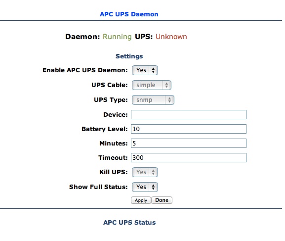

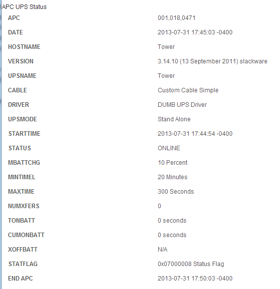

I've attached two images that show what the plugin is giving me on the settings page.
Any help is greatly appreciated
