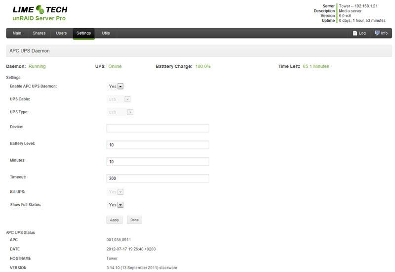

What exactly is the Device-Field, just a text-field to enter the name of our UPS?
I would like to know a few things myself:
- what is the timeout for exactly?
- what does 'minutes' stand for? And what is the difference with timeout?
- what is the battery level textbox? Shouldn't the package read this from the ups?
Basically i want the ups to keep the array up as long as possbile, and only power it down when the ups itself will run out in like 5 or 10 minutes. According to the screenshot the UPS can keep the array up and running for 85 minutes.
Lat but not least, why arent these settings discussed in the start topic? :o
This is how long the system will wait after the power has been cut before initiating a shutdown.
This is the number of minutes estimated battery run time should be remaining before initiating a shutdown.
This is the percentage of battery charge which should be remaining before initiating a shutdown.
The shutdown will be initiated when the first of these three conditions is triggered.

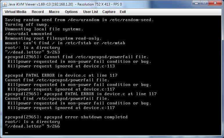

Using the 'powerdown' command, at the end i get an APCUPSD related error, see screenshot.
Anyone know what this is all about?
as described in the photo, there is no /etc/apcupsd/powerfail file.
(apparently, it was not installed or configured properly for your version of apcupsd)
Joe L.
I got the plg from the unraid plugin site, placed it in the /boot/config/plugin folder, ran installplg on it, it installed succesfully, and i have the menu item in the webgui, which can read my APC ups. So as far as a linux newbie is concerned all is well, and i assume the plg is correct and not faulty? Any ideas on how to check what might be missing and why? What is the 'powerfail' file, is it part of the apcups package?
I do want to know upfront and NOT when the power is cut unexpectedly as you can understand...
I think this was a typical SHIT case. Self Healing IT. Re-ran the apcupsd package, and used the powerdown command to shut the device down, no errors, started up nicely afterwards again with no errors, so i guess its solved...
Is this also in minutes?  The default is 300, which could easily be 300 seconds or 5 minutes, so I just want to be sure.
thanks
Nevermind.  After I started it with full details, I saw that it's actually seconds.
I changed lines 240 thru 251 in the plugin to reflect this in the config, so I don't forget :)...
