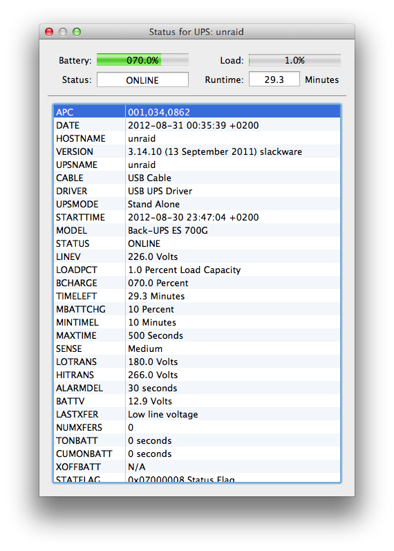

works great in 5 RC6 with an APC Back-UPS 700.. well, not the %Load but its a UPS issue.
Today I test powerdown and no problems. Perfect Log.
Also I test remote info in Mountain Lion and working in a couple minutes.  ;D
All this, after I return a Riello USB UPS that I could´t make it work at all, not only in apcupsd, in ML.
In a couple of days I´ll try kill-ups to powerdown and restart after poweron ups.
Captura_de_pantalla_2012-08-31_a_las_00_36_19.png.be34f02bc498c652a946a66a94d15829.png
