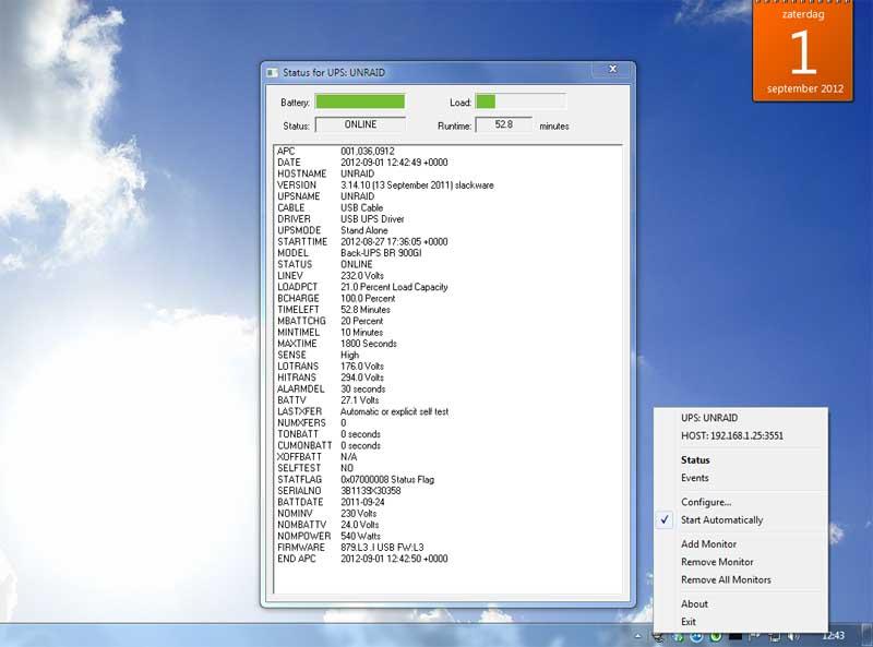

Where did you get the screenshot? how do you get the data via a popup window?

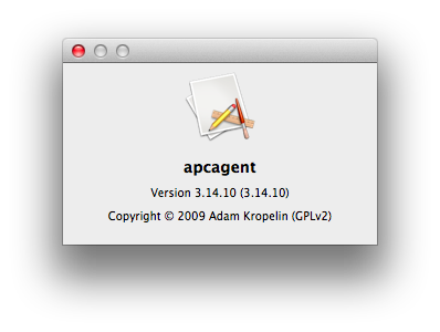

in my MB Air - Mountain Lion with APCAGENT installed with Apcupsd-3.14.10.dmg
No need to to nothing in the unraid side, only in your remote PC config with ip, port, etc..
Captura_de_pantalla_2012-09-01_a_las_01_08_44.png.5d024ff7fa20f74bca6ebab43f7bbcf9.png
