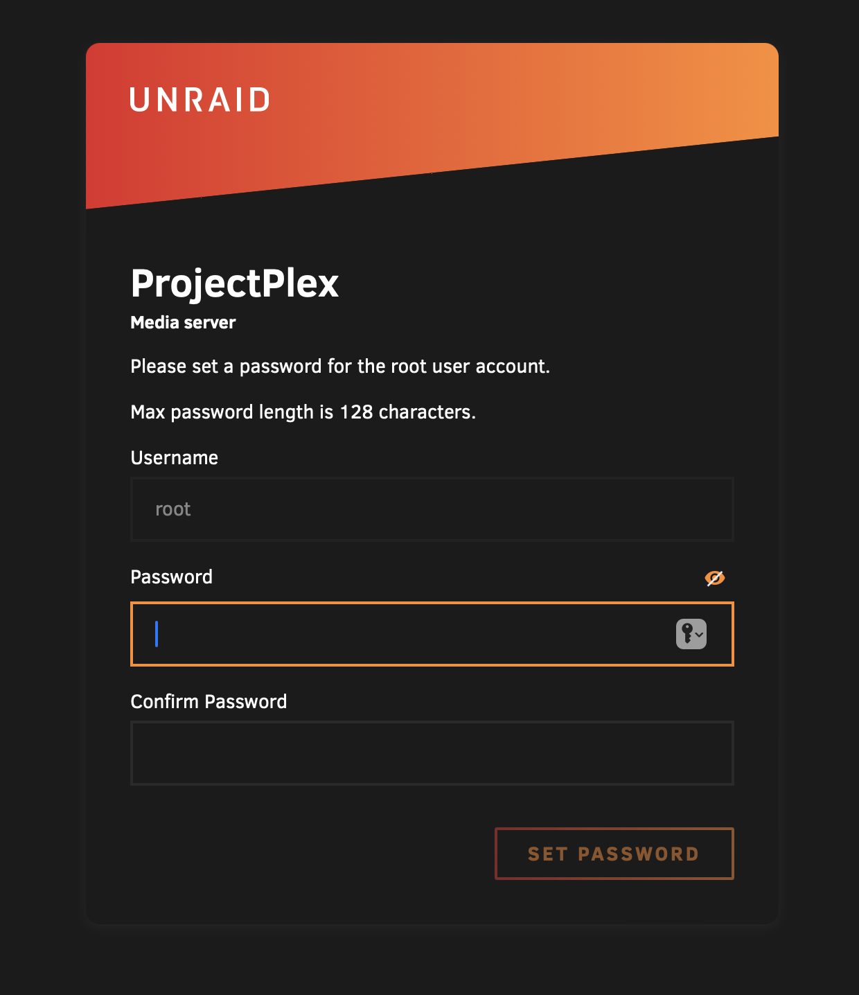

So I thought it was a smart idea to update the OS, I did this using the tool tab in Unraid. after the update I rebooted it and got the screen below:
I tried to make a password a few times but it just shows a blank page after I clicked set password. a simple refresh got me back to the page as shown in the screenshot above.

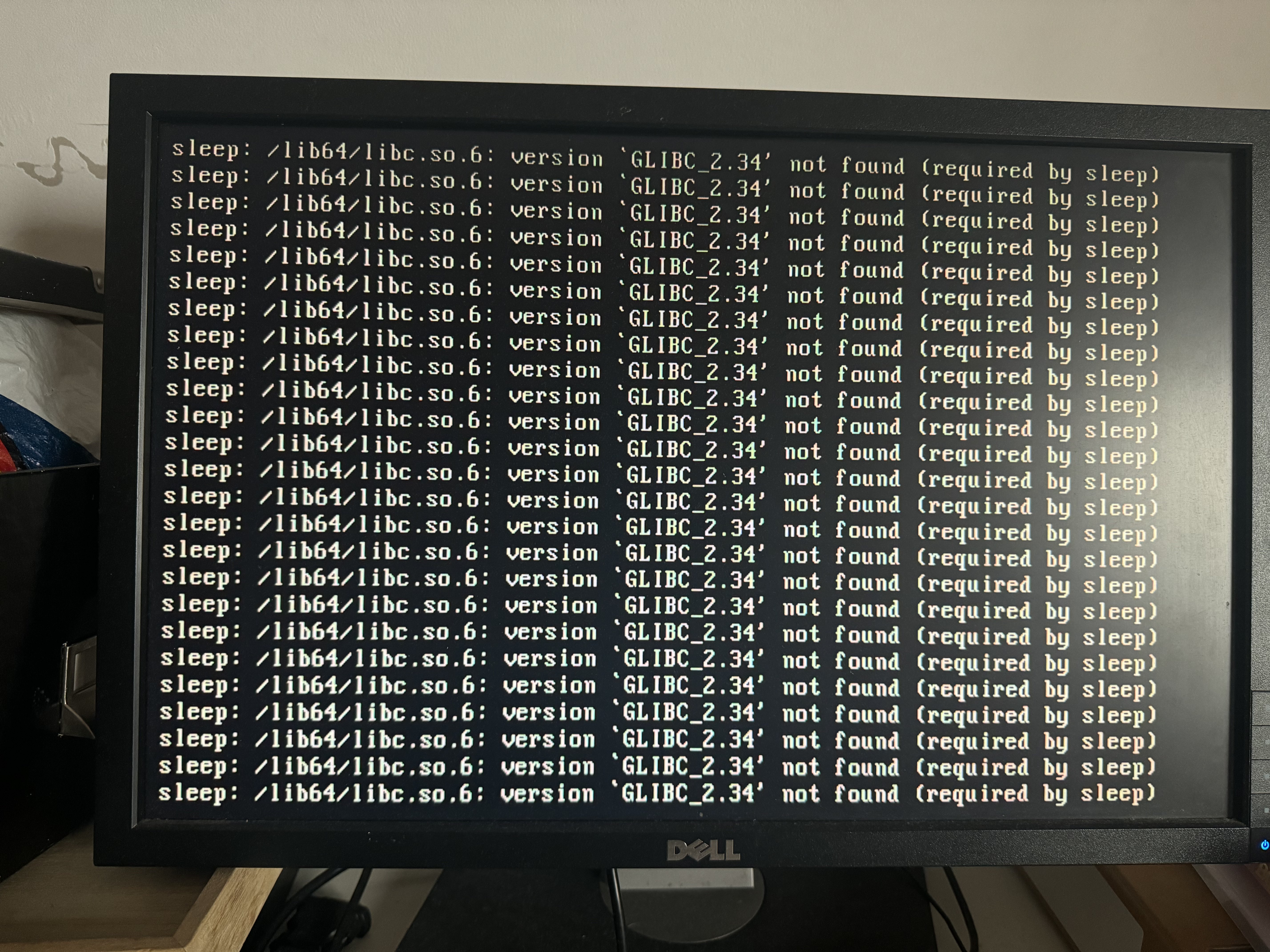

I decided to hard reboot the system and watch the monitor hooked up to the unraid server. Then I got very very worried when I saw this screen:

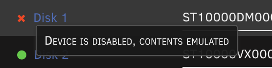

I checked the cables, but now disk 1 shows up disabled, and I have no idea how to enable the drive.
Is the emulated disk fixed? Post new diags.
You're using a Marvell controller with SATA port multipliers, either one alone is not recommended, but both together can be especially bad, not surprisingly the disable disk is connected there, but there are al lot of ATA errors for the other devices connected to that controller, I would strongly recommend that you replace it with one of these.

13 minutes ago, YoloSwagLord said:
The disk still seems to be disabled when the array is started.
The disk will stay disabled until you successfully rebuild it.   The fact that the emulated disk1 appears to now be mounting fine is a good sign, but you need to sort out the disk connection issues before attempting a rebuild or you are likely to get a write error during the rebuild and the disk promptly disabled again as a result.

Thanks for your reply, I rebooted in to "normal" mode and the issues as described in the topic still occur (GLIBC_2.34 not found & new password).
when the disc is emulated this shouldn't be the case right? I should be able to boot in to "normal" unraid and my dockers should be running right?
btw. im gonna order a new raid controller for sure, but need to be able to get the server back up online while the new controller is in transit.
I just rebuild disk1 with the check file system with the arg -v. But the disk stays offline/disabled even when I stopped the array en started it again.
That message is coming from a plugin since you say this only occurs if you do not boot in Safe Mode.  You need to find the culprit and remove it to get rid of the message.

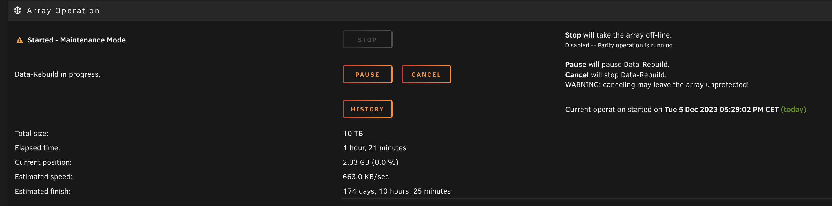

Thanks for your reply, I chose to do the rebuild since the SATA is now connected to the motherboard instead of the controller. all the checks looks to be correct as in the attachments of previous reply's, but another issue occured.
the speed of the data rebuild is very slow (500kb), with that speed its gonna take 200 days to complete the rebuild. I did the rebuild in maintenance mode and clicked the button sync as described in the topic.
1078441032_Screenshot2023-12-05at18_50_10.thumb.png.f157f48f0b234a5f85bde1e6d730491c.png
Likely still having issues with the other disks connected to that controller, check the syslog for ATA errors
